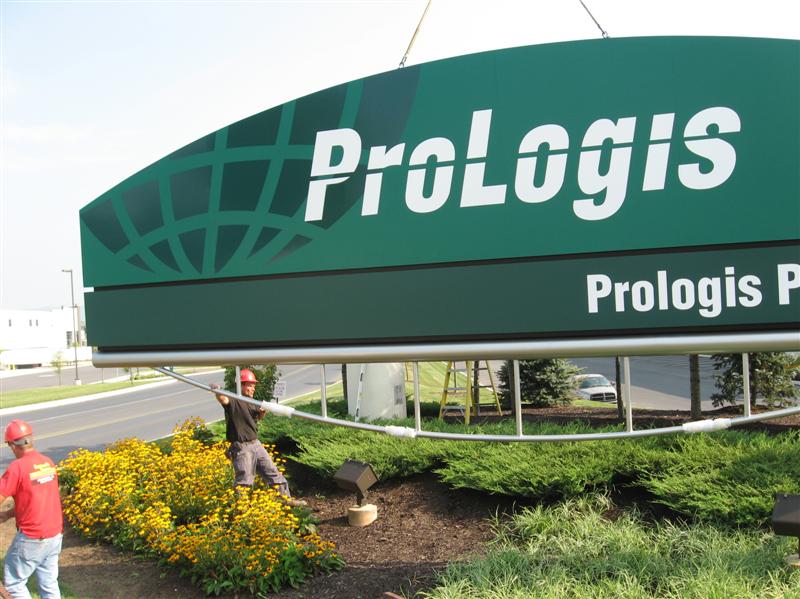

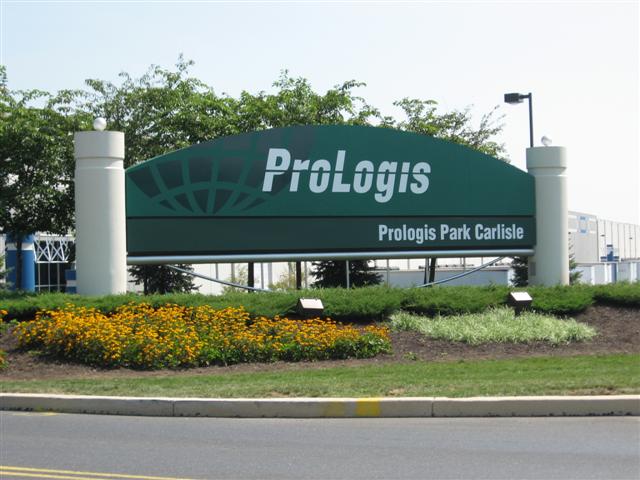

the 4'x32' cabinet with channel letters was installed with 1/2 big tapons and the monument was installed between two existing concrete poles using hilti drop in threaded inserts and hilti expoxy and tightened down with 1/2" bolts..

While the "Prologis" sign is very nice :thumb:, its sandwiched between 2 concrete pillars. Not at all the application we are discussing. (ps. would love to see some pics during the fabrication stages if you care to post).

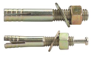

Perhaps you should read up on fastners a bit more also. You would cringe using these 1/2" hammer anchors?
http://www.fastenal.com/web/products/detail.ex?sku=52309&ucst=t
http://www.fastenal.com/web/products/detail.ex?sku=0129055&ucst=t
Like your tapcons, there is a proper size for every job......and while I wouldn't be afraid to use the "lowe's" hammer anchors on a teenie 3x6. I surely wouldn't use them on something larger like you've shown.

The ones you just posted are fine because you can remove the sign without using an angle grinder and butchering your sign. The ones I have been referencing are junk plain and simple.

I'll see what I can dig up for fab pics, that one took up some real estate, it's all 2x2 x1/4 alum angle frame with kerfedangle top and routered panels and flush cut to ends of frame. Removable back side panels for accessing bolts. Poles were from another sign, used a laser level from one pole to the other to get center of poles to place fasteners, thought we would have to set the trucks up at away so I had a 30 Ton crane on standby but we ended up using my buddies 97' manitex:cool1:
