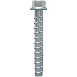

drive pins are great but I also like to drive 2-4 of these in depending on the size of sign. titen HD. you drill hole and screw these in with socket wrench and its not easy and they hold!
we stock those in 3/8 and 1/2" they are great. run them in with a cordless impact
