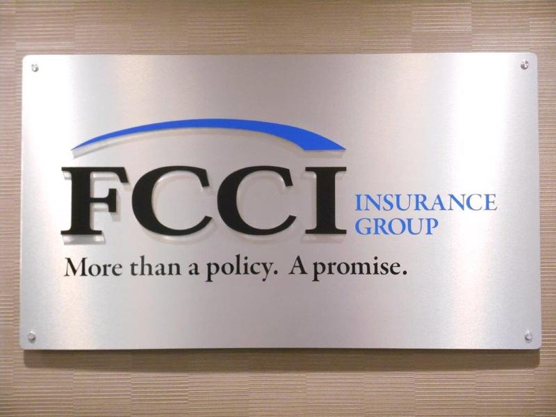

Pic of Sign Installed
Our installer didn't take a pic of the completed sign installed. So, I asked the client to take a pic and email it. I would have liked a better angle, but this is what she sent. Looks good and I hope the acrylic holds up! Thanks for everyone's input.
