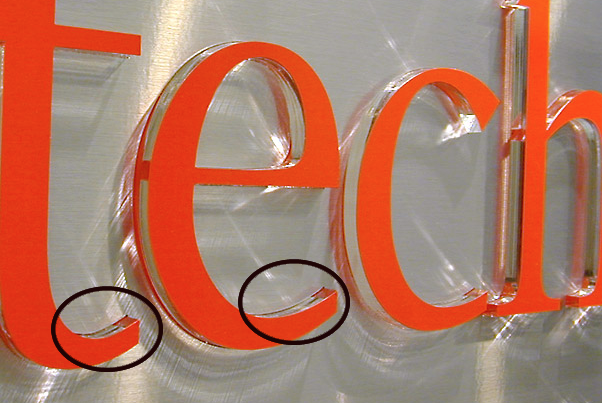

The picture looks to me like the aluminum is routed out and the letters just fit in place. I could be wrong but that's a possibility.

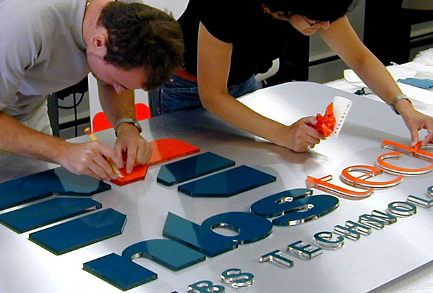

You may be right, but I've attached another pic of the sign being made. I didn't originally envision your thought. It looks like the acrylic pieces are being mounted with some type of tape backing. There could be outed out areas too.

PushProductions
Yea i cant tell much from the new picture. The only sign I see of it is on the first picture. On the T and E right on the tip of where i circled it seems to be a little gap.
attachment.php
Edit: If it is aluminium its pretty thick(Could possibly be another substrate wrapped in aluminum vinyl . It may not be routed out comptely it is possibly just routed 1/4 or so in. Doing this would take minimal glue to hold the letters in place.

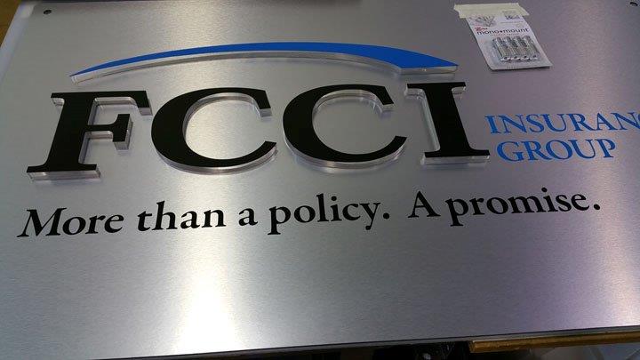

I've been talking over some of the ideas with our production guy, and as I mentioned, the aluminum routing is out. Looks like we'll probably go with some type of double sided film or tape. I agree that it won't have to be perfect (although that's what I wanted), but it will be on a wall and should look good from a reasonably close distance. My concern with tape/film is making sure there are no bubbles or obvious imperfections. No ones going to be standing 6 inches away from it, scrutinizing it. I'll let you know how it goes.

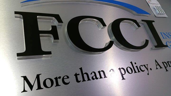

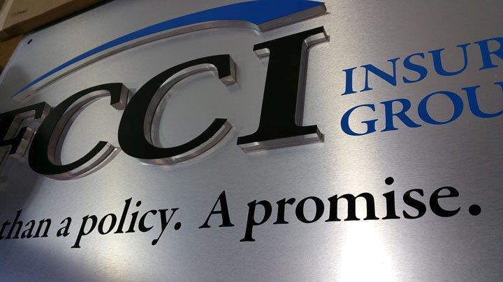

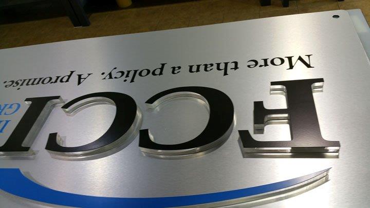

Finished Sign Pics
To all that replied to my thread, thanks and I really appreciate it. Our production guy put the sign together, and I thought I'd post some pics. I thought it came out great. What he did was apply vinyl to the complete back of the letters. The vinyl he used is a light grey on the adhesive side. He applied this making sure that he got all the bubbles out. Then he applied the letters to the brushed aluminum with VHB. I was hard pressed to see the vinyl backing, and I'm sure once it's on the wall, it will look great. I'll upload a couple pics once it's installed. I'm very pleased the way it turned out.
