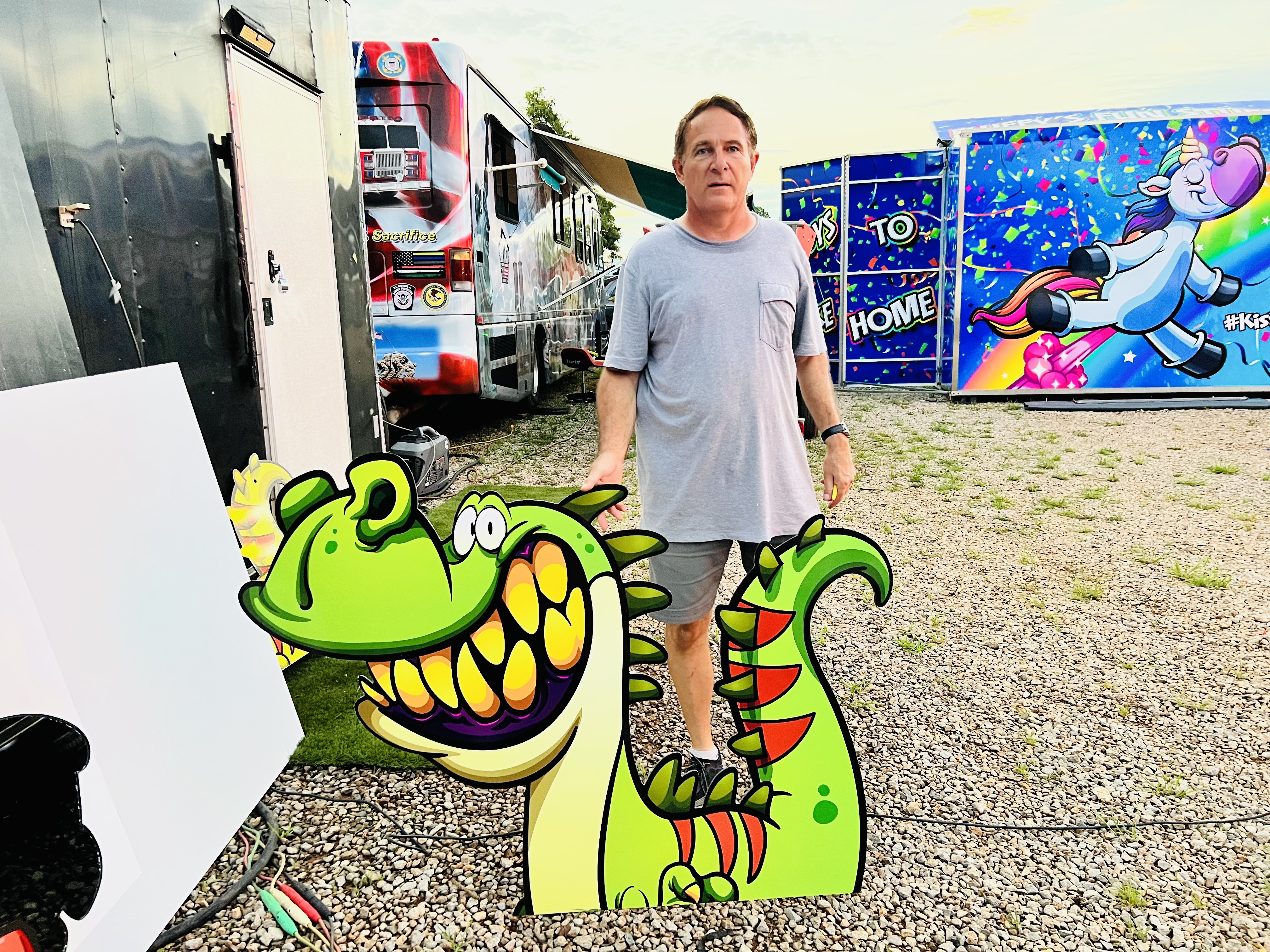

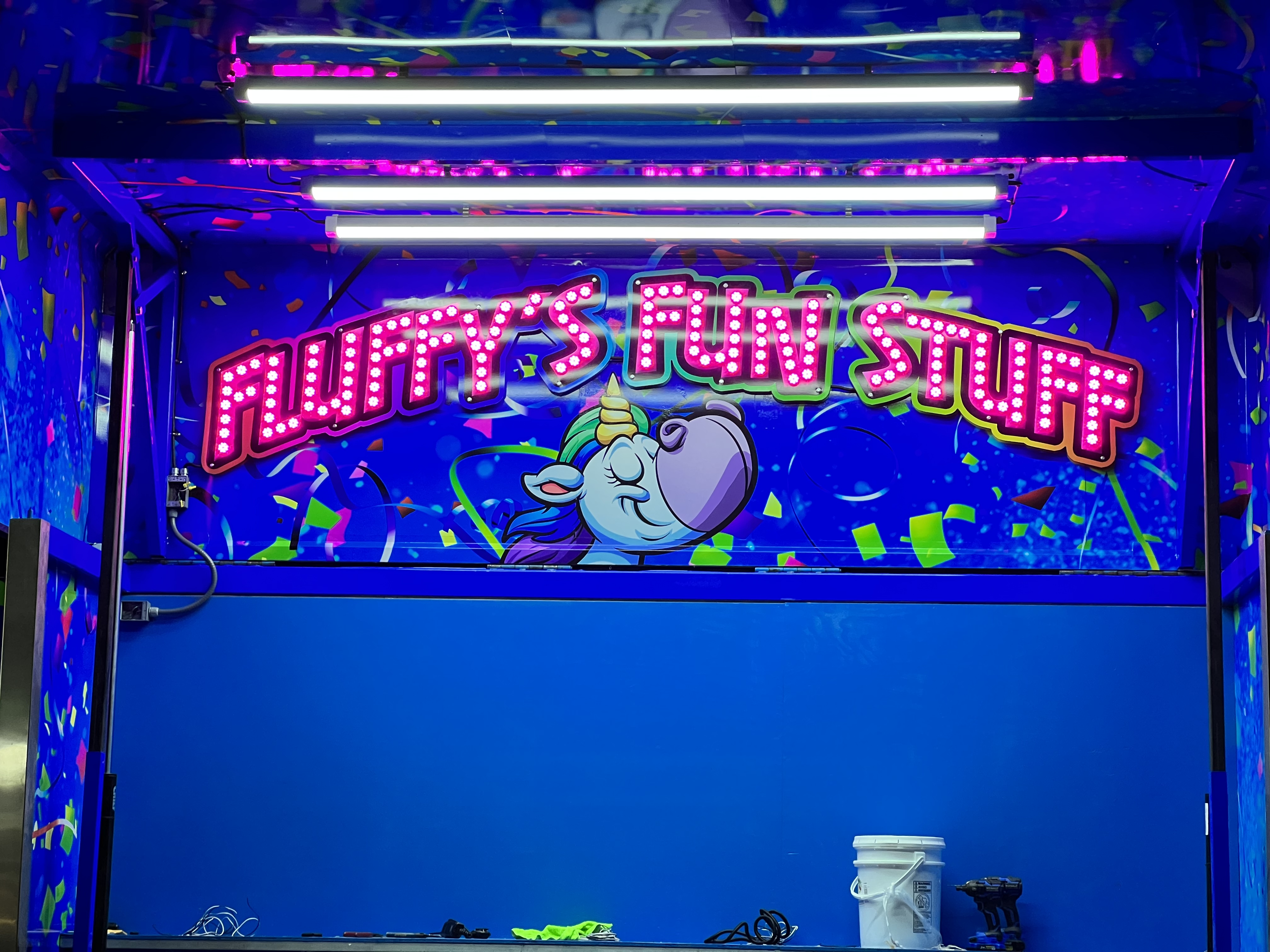

We bit the bullet and got the yeti Smartbench precision pro from digital woodcarver. After a bit of a learning curve, with the V-Carve Pro software and the Smartbench, we are getting fantastic results with cutting 6mm MaxMetal with wrap vinyl applied. Very accurate machine and you can cut edge to edge on a 4x8 sheet.
