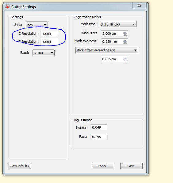

On SCAL or EasyCut these settings can be used to calibrate size.

Thank you for your reply. I have adjusted both of these to 98. However at 100 it cut a 1" square perfect to size. larger cuts are still larger than designed, but closer to the designed dimensions. If I adjust them any lower it will likely make smaller cuts too small. Being that both The cutter and my printer/cutter exhibit the same behavior using 2 different softwares. it leads to me believe that there is something else causing this. And this occurs on every project I do these "overlays" on. So its not just one particular design.

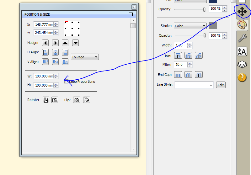

Rjssigns I tried that also. Doesn't seem to do anything. The only thing That changes when doing that is within VersaWorks, it changes the overall dimensions but I assume that is due to VersaWorks having one less decimal value than AI but doesn't seem to change the cut size.
