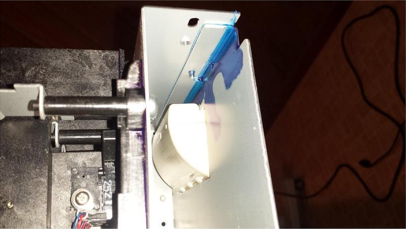

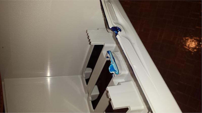

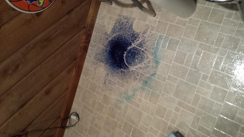

was just in the middle of printing a job and noticed the printer stopped printing, I walked across the room (small room) to find Cyan ink splattered all over the wall, floor, and down the leg of the printer stand. It ate through the data cable (which is why it stopped printing) and destroyed the vinyl flooring by eating through it. I quickly pulled all the ink cartridges out and the Cyan Cartridge had ink pouring out of it. I removed the plastic that the cartridges slide into but it was already melted to the machine and melted INSIDE the machine. Can anyone shed any light on this for me? Im at a total loss, in more ways than one. I don't see how this could be caused from something that I did, or didn't do. The cartridge was an EnduraInk from Signwarehouse, Which is what I have run in the printer since the day I got it with ZERO issues. I just have no idea what to do or who to contact at this point. The printer is out of warranty.:banghead:

sounds like the foil bag failed or wasn't sealed and melted the cart and cartridge holder, I would recommend calling Grafx Network, I think they have a tech in Blue Springs, MO that can help.

Yeah, it made a mess. Just to update a little bit. After further inspection I found that I have some air bubbles in one of my Cyan lines. I am assuming that because the bag in the cartridge blew it allowed it to suck some air. Still curious if this could be caused from anything I did or didn't do properly.

Alright, heard back from SW. They are going to send whatever parts are damaged, along with new ink, at no cost. I guess it is very rare for this to happen so of course it happens to me. I guess I'm on my own for the flooring tho, which of course will be the most expensive part. Thanks to the few of you that replied.
