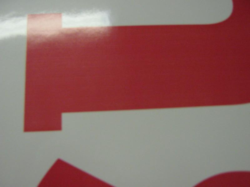

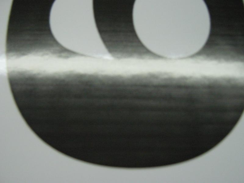

Help!!! I have a Mutoh 1204 I have recently changed the Maintenance Station and now I have terrible white streaks and I have done everything I know. I am out of options other than replacing the head ! AnY HELP ???
SSIGNS DC
Thank you for any help you can give!! I tired these pictures I not sure it does it justice.

The nozzle check is ok there are one spot in the black and one in the magenta and i cant get them out I have been trying to figure out how to do a alignment but i am not understanding the Manuel very well.

I would love to have a tech, except they want over $1000 just to get them out here to SW ks to look at it. I did get an alignment done it was off but still have streaks.
