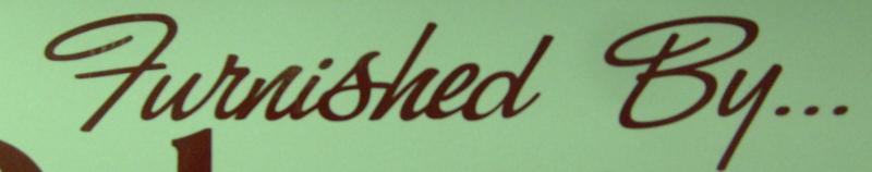

Well this is the font that I can't find. Anyone have an idea of what it is?
