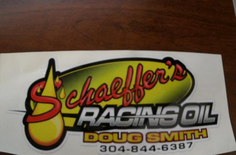

I need to get it to look like the one cut out all ready.
