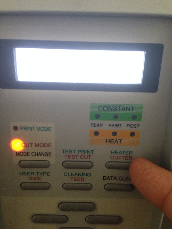

On the printers panel, before you start cutting and before you press remote, press the heater button on top right, itll go into the heater settings and then you go up or down, left and right to adjust the heaters.
ironchef
This button

108 Designs
This button
Thanks for the reply, I'm pretty sure I have done this but I will try it again today..
If I remember correctly, the last time I did this it would heat up fine, and as soon as it started to cut the constant lights would go out and it would cool down..
I'll keep you updated.
Thanks

I agree, when im in cut mode ready to cut, i can goto print mode real quick, turn the heaters on and press cut mode and that should work
ironchef
When your in heater settings, push on the arrows up or down to the temp you want it on, left to right for all three temps, hit enter. Then go back to cut mode.

yeah just tried this, all works fine, heats up to temperature, put it in remote stays constant, then as soon as i hit cut on the PC and it begins to start to search for the crop marks, all lights go out and heater turns off.
Just a thought.. could it be anything with the profile I am using?
