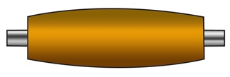

laminator rollers are not supposed to be flat. They should have a slight crown in the middle.
This is exaggerated, but this is the general idea:
  • crowning-services-converting-industry-rubber-rollers-menges-roller-company.jpg

This would indicate that the rollers still have a crown to them. The next statement seems to contradict that.
If they do in fact still have a crown, the culprit would be either Laminate Tension, Print Tension, Roller Pressure, Speed of feed ...or a combination thereof.
