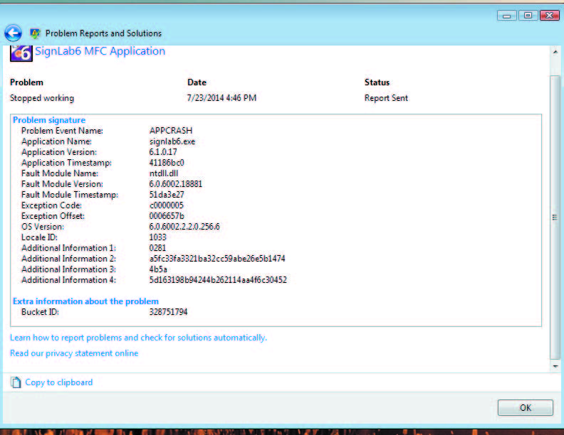

Ok, I know its time to upgrade, but I don't have time for that right now. Pressed for a huge cut job, I need to get this working asap. I recently had my xp pro computer crash and was not able to recover. My IT guy highly recommended using Vista Business on my new computer saying that it should run all of my programs with no problems. Well, SignLab turned out to be the problem. I actually had the patcher.exe and update S610617U saved on a backup disk so I moved them to my signlab file and ran my updater, but I'm getting the (*v*) on my updater so I don't think it's updating....tho it won't let me update again :/ When I try to run SignLab, it goes through all the motions until it gets to the cut program then I get a "SignLab6 MFC Application Has Stopped Working". My IT guy thinks its a problem with the program, but I sent him this screenshot from Vista and haven't heard back from him yet. Just wondering if anyone has any ideas that could help....really getting stressed with this big cut job deadline looming over me!!!!

it doesn't give me a port message and this morning it gave me a "dll error type 0" whatever that means. I still think it has something to do with e6 not playing well with Vista. On the screen shot you will notice the "Fault" has something to do with the ntdll.dll. I think if I could clear up that fault, the (*V*) stuff would go away....maybe not, just need to do something. I might even have to hook the old backup computer up long enough to get this job out! e6 is already loaded on it and was working great when I shut it down. Just don't want to have to rely on it too long.

Got a big issue with this (*V*) thing. My windows xp pro computer crashed and I had to replace with a new. My IT guy told me to go with Vista Business so I would still be able to run my programs and not have to upgrade everything to work with win 7 or 8. Installed e6 on Vista and had no issues till I tried to update....no longer supported by cadlink! Ok, so I managed to find the patcher.exe and the s610617U update and ran them. Now I have the (*v*) issue with my updater and...SignLab will go all the way through to the cut mode with no problems then I get an \"MFC Application has stopped working\" and it shuts me down. When I check the \"Problems and Solutions\" folder in vista, it showed me that the \"fault\" was an ntdll.dll fault....whatever that means. Occasionally I get a \"dll error type 0\" as well. I really need to get this working. Have a deadline on a huge cut job that I need to be rolling on! Also, yes, I have installed my hasp key and ran the drivers for it. Ive uninstalled and re-installed this a couple of times...nearly at my wits end!

easy things first, the (*v*) indicates that the language you have chosen on install does not match the language specified on the password (Usually English international and English US).
The MFC application error is difficult to track down, so I don't have any great ideas on that, the DLL error type 0 will be something to do with the cutter driver chosen as a default. Go to File > Install Cutters and remove all drivers except the one that you need for your cutter.

rayw.....you are the best. if it doesn't matter about the (*v*) thing...I won't worry about it since there are no more updates for e6 anyway and this one is already installed. The DLL error type 0 went away as soon as I got rid of everything except the one I need. Along with that, the MFC error went away too!!!! God Bless the good people on this site! I contacted Microsoft about the MFC error and they said they had a fix for that, for a small fee of $99....really? I've been using SignLab since v4.95 and will upgrade as soon as I am able....LOVE this program! Want to go to 9.1 but the piggy bank isn't full enough yet! Thank you again! Gotta love the way Cadlink works!
