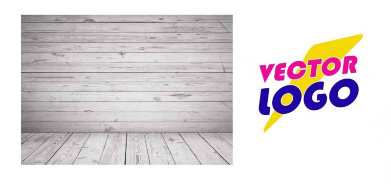

I'd like to take a vector logo and superimpose it on a textured background... But instead of it looking like a solid vector, i'd like it to look more like it was originally painted on the textured surface. I tired using the transparency tool, but it didn't come out as well as I think it can.
This is an example of a textured background and the logo i'd like to put on it.
I don't even know what this technique is called to look up how to do it. Does this have to be done in Photoshop? Photopaint?

If it were me I would rasterize the logo and take the work to Photoshop where you can dodge, burn, and transform/skew the logo to hopefully get the effect you are wanting.

Convert the logo to a transparent bitmap.
In Photopaint or Photoshop apply a bump map to the logo bitmap created from the wood background.
If you want it a bit weathered, add a little transparency to the logo bitmap.

Could just try clipping the logo to a copy of the background then add a couple effects. May or may not get ya where ya wanna go, but its a start.

oh i was thinking photoshop...not sure how or if you can in corel(draw) -- you can probably do it in photopaint, but I am lost when i comes to photopaint
edit: actually, try to play with uniform transparency, and change the 'transparency operation' (default is called normal - second dropdown in the toolbar) to multiply
I have photoshop, but it drives me crazy :) I need to take a class or something. I used to have a basic knowledge of Adobe CS, but once I started working with Corel, all that flew out the window.

edit: I did try the transparency options, but they didn't look that great. I think it needs to be rasterized.
