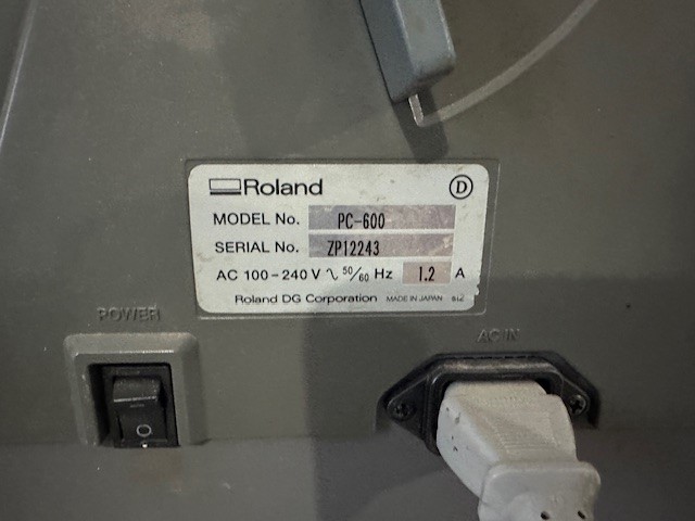

I am trying to be a good neighbor and help our local Cub Scout Leader & Teacher, She has a lot on her plate.
She used to have a business making Vinyl for Horse Trailers but now make everything for the local Elem. School and everything for the Kiddos Scout stuff.
Her Roland PC-600 has been sitting for a few months INOP, I have the PC working again Temporarily, but it seems to only cut when I have Oddball settings chosen in the Print menu.
While in COREL 9, she says there was a "Paper Type" that she would have to Manually Enter, but when we attempt to do so, the Text field just Zeros Out and leaves "0.01"
I got it to Cut once, but it was not to proper dimensions, I was happy enough it actually Cut the Design out lol.
I would like to attempt Building a New/Used Windows XP Machine: I believe I have a Q8400 that should run XP seamlessly, I would like to it have Working 100% before taking it to her.
I Also have Purchased the IEEE-1284 to USB Cable, but haven't tried it on her old system yet due to the Easter holiday
However, I cannot seem to find Any Software needed, She has her Copy & Lic. Key for Corel 9, but I cannot locate any of the Proprietary software from Roland besides the Drivers.
This Thread here States I should Need "RCC Version 4.1" But I cannot find it anywhere: Or any Software for that Matter.
