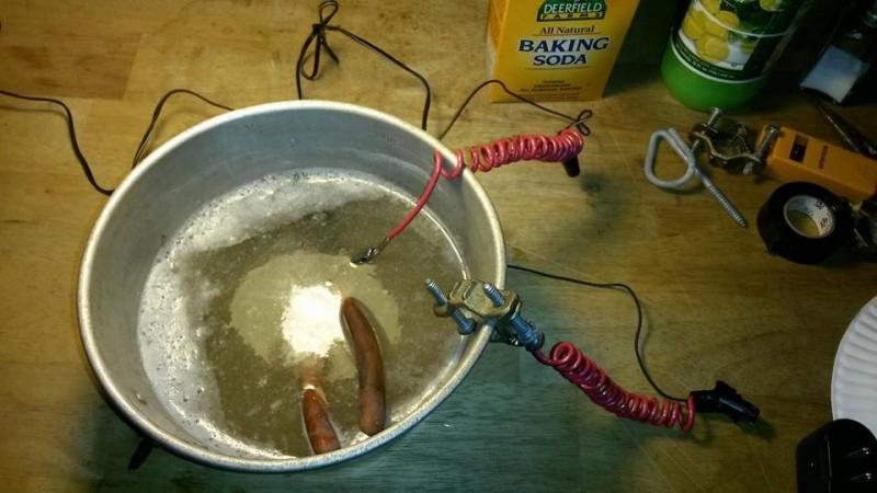

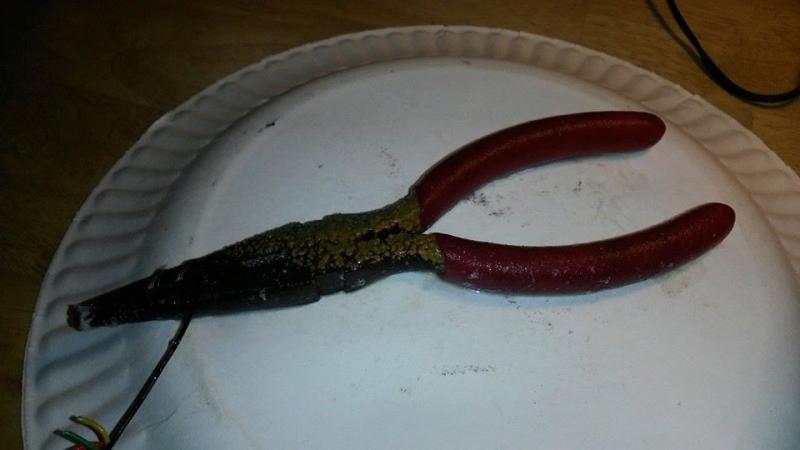

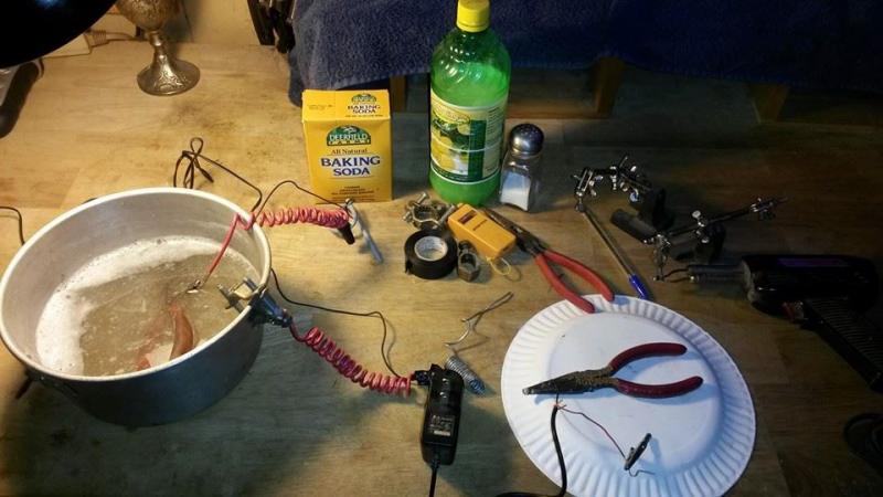

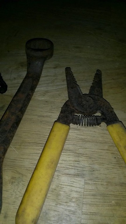

Made a home made Electrolysis Machine to clean any rust from tools and just about anything.So far it works great.I used a 5.2 watt and a 6 watt Cell phone charger.You can use basically any volt but the higher the volt the more you have to keep an eye on it.Yo can use 1-2 gallons of water and 1 table spoon of Arm n Hammer laundergent and a tablespoon of salt to a 5 gallon bucket and use rebar for a grounding rod and hook it up to a car battery.That would be good for bigger items.The pliers you seen in the pict were hooked up to the 5.2 watt for about 15 min.I would leave things in longer if there really rusted.I won't go into to many details how i made it cause of my poor writing skills so heres a few links.Works great so far.
