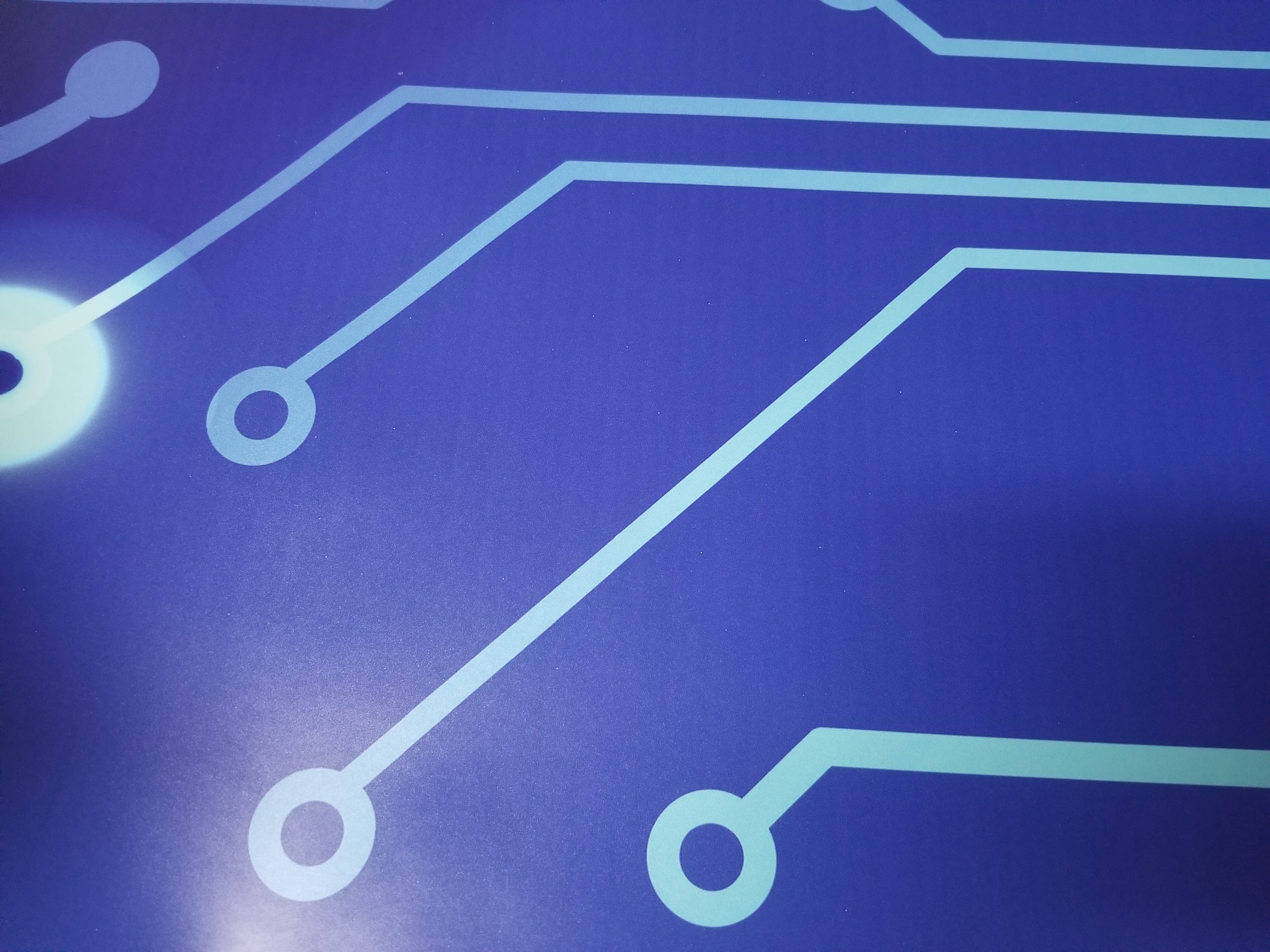

So, I have a HP L26500 and I have horizontal banding in blue color only. I normally have this problem in black color, but now it's fine. I've changed both cyan printhead tried different material and profile and I still have the problem. I have printed the ''test'' print and everything is fine. I also made a printhead alignment even if it was already done after the changing of the printheads.
What should I look for or test next? Thanks.

I've forgot to mention, if I print a cyan, magenta, yellow and black square (12inX12in), everyting is fine.

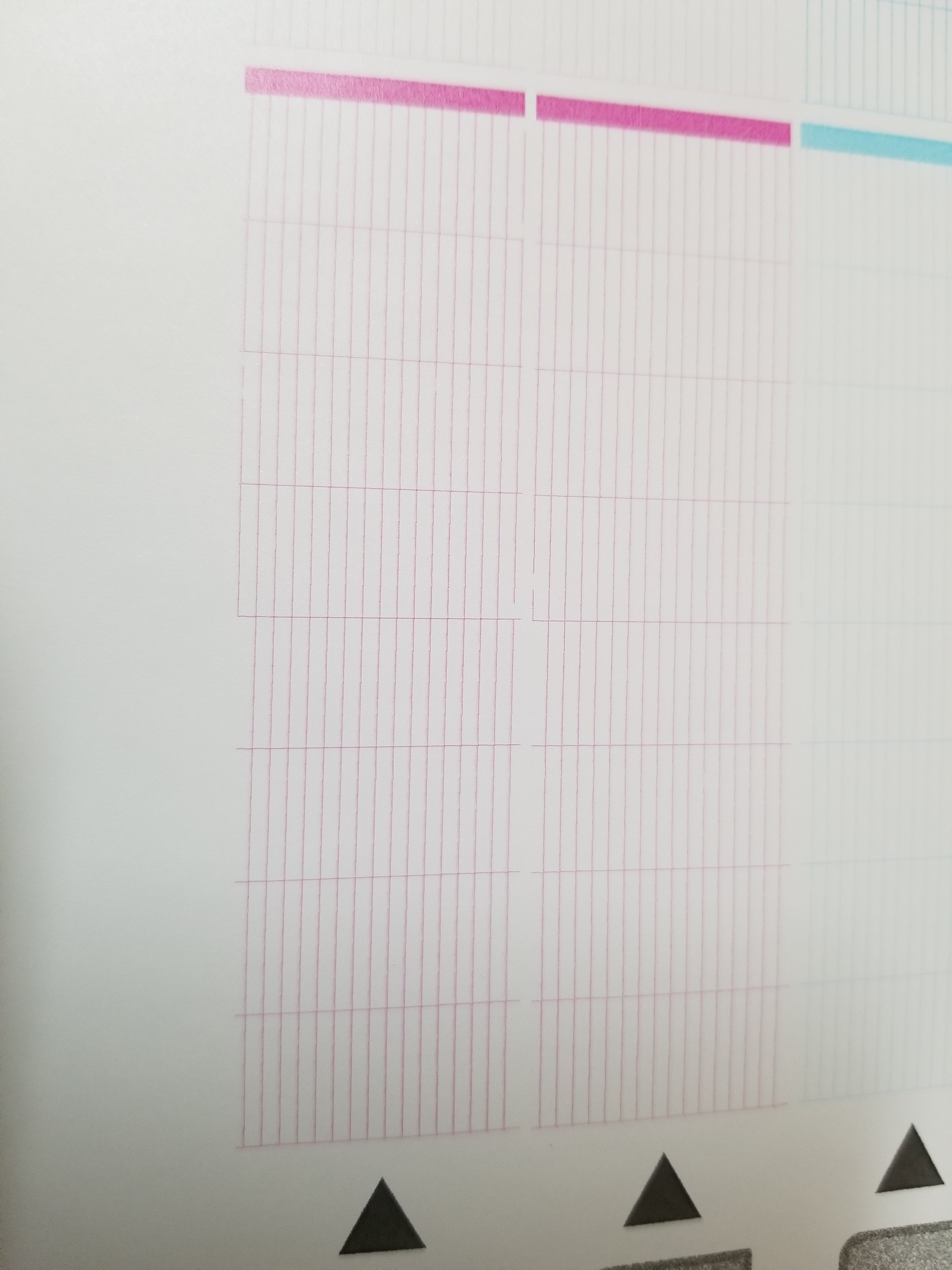

what does your test print look like? big fan of the one via the clean printheads menu, as you can see the individual nozzle-lines.

I have to say I did not try other pass than 10. So, the printhead cleaning kit have been changed this monday (with the ink funnel, filter and bucket) . the maintenance kit is at 68% right now. As for the test print, here are the picutes.

you're looking at the cyan, but your banded image certainly has magenta in the mix. what does a 10pass magenta box look like?

i do sometimes get slight banding on 10pass, which is why I rarely run it. 16pass fulltime, unless i'm in a rush and I dial it up to 12pass. I have a feeling those knocks in your magenta nozzle test might be the culprit. higher-pass rates fill-in deflected nozzles better, although the color might not be as true as a 100% nozzle test patter.

I've just changed the ink maintenance kit and that thing was nasty compared to the ones I've changed in the past. If I print on cheap poster paper, I have very small banding. If I go on the vinyl, the distance between the banding have shortened and are less visible, but still there. If I print a black and white image that I would normally have problems with it, everything is perfect. If I print a regular photo, everyting is good. It's just that particular blue image that give me trouble.

Is it happening on all media or just one?
on all media, but on cheap poster paper is a bit less visible. But like I said, after changing the ink maintenance kit, there still have banding but they are thinner now.
is there some kind of texture in the back ground of that file that might look like its banding
no texture. It's a gradient, but the lines would be at 45 degree if it was the gradient. If only I had another printer, I would test it to know if it's the file that is the problem.
