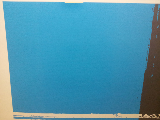

sometimes im getting these horizontal lines in print. I did a photo, but it doesnt cleary show them.
I can see that ink is layed differently every second line...
It happens occasionaly... i did strong cleaning, i maually clean head yesterday. turn up heaters...
Probably when i will start new print these lines will be gone... as usually.
Im just wondering why they show up???

Vmishev: i would send a photo, but i dont have enaugh good camera! I took some photos... will post it...
Randya:
Yeah, uniderctional prints so slow, and i had a job, that was in hurry.... Temperature - it was set to 30 celzium... i think i cant get much lower...

Hard to tell, but it looks like chromatic.
Sometime (depending on media, environment) higher temperatures can help.
Also important that Bi-direction alignments are good.
