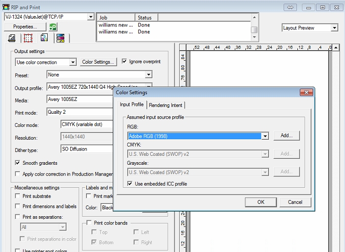

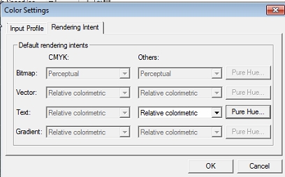

So any input to my colors being off when i print? I looked the pantone colors up and they are actually different than a college shows them to be. I have the email from the college stating the color and the mix in cmyk.
I have also had them look at the color setting under color correction in flexi. They show to be the same as mine.

Are you printing with the same model printer and inks they have?
Granted they are not the same printer. Yet I have been trying all morning to get a match out of my printer and I can't even get close. To dark or to purple or way off. I am just trying to narrow down one color. I guess I assumed if the printer only saw a specific mix of cmyk then it would be in the close ball park yet I am very wrong lol.
I think you would be amazed at what profiling to G7 would do to your color match. Many of the good printer dealers have a G7 expert that you can hire for a day to come out and show you how to make a profile for your printer. It's not super hard to do. You need a measurement device like an iOne and some software called Curve 3 which helps you to build a profile -- and last but not least, a RIP that allows you to use those profiles.
Creating custom profiles is important because each different medial that you print to has a different white point and different ink holdouts that will make the color look different when you print to them.
altereddezignz
This may the end result is to hire someone to get this accomplished for us but at the moment we are trying to keep our budget down as we are still getting started so that may be out of the question a the moment. Here is a kicker. I can change between 3-4 different profiles and get no color variation at all. Heck i have even tried printing without a prifile with heats on and i get pretty close to the same color only the ink is to thick. Could my ink be drying to fast and not letting the color mix as well since i am having a grain type issue also unless i print in full quality 2 setting on 1440x1440 res?
