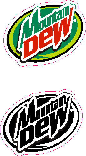

Jackpine
cut line
Like this? The magenta line is the cut line.
