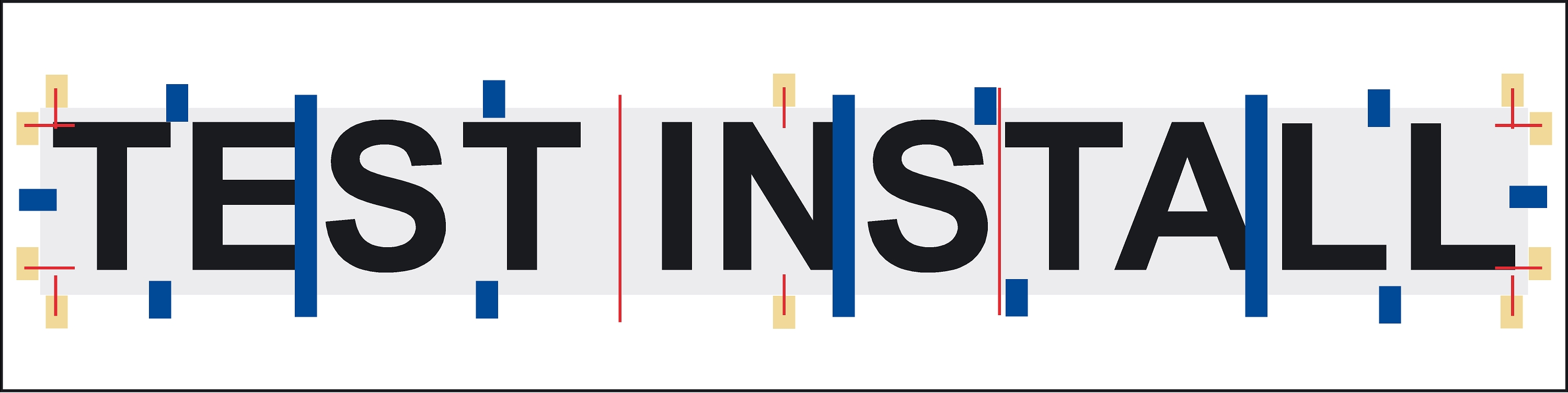

IF this is just cut vinyl letters. Find the center of the graphic and mark it with a wide marker. Find the center of where the graphic is going to be installed, place some masking tape on the sign and mark the measurement on the tape. Do the same for the rest of the measurements. I prefer a good 3M Painters tape to hold it in place, like the [HASHTAG]#2094[/HASHTAG] 2in wide tape. Tape the whole thing up. Make a few cuts and lay them in parts. The other way is to do a top hinge and lay each letter individually vertically instead of a few letters at a time horizontally. This does work for printed graphics, but that would be too risky to install onsite and need to be brought in.
