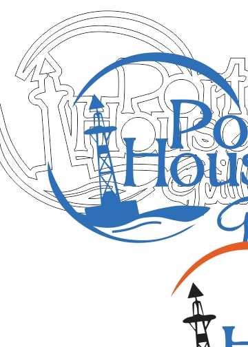

Thanks, I got it to work but even with just 1 step put in i get multiple contour lines.
Also, the outline is very "pointy", Any way to round them off?

Select the points with the shape tool that you want to round off.
Open the "Fillet/Scallop/Chamfer" docker (this is a good one to keep anchored to the right side tool bar).
From there you can adjust the fillet size and see a live preview of what the result will be as you change the numbers.

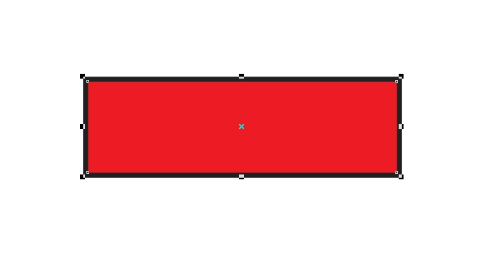

Here is what i mean, Like see i have the rectangle with a thick outline, How do i make that one solid shade? Even making the outline and fill the same color i can't figure out how to make it one solid shape. Tried weld, convert to object and everything.
Convert the black outline to an object, then you can color it red and delete the smaller square. If the black was done with the contour tool you have to "break contour group apart", then you can delete the smaller shape.

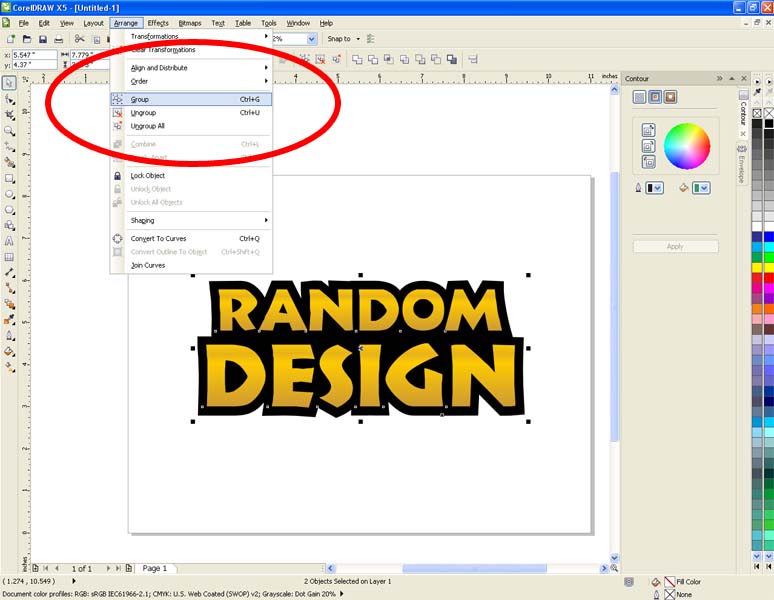

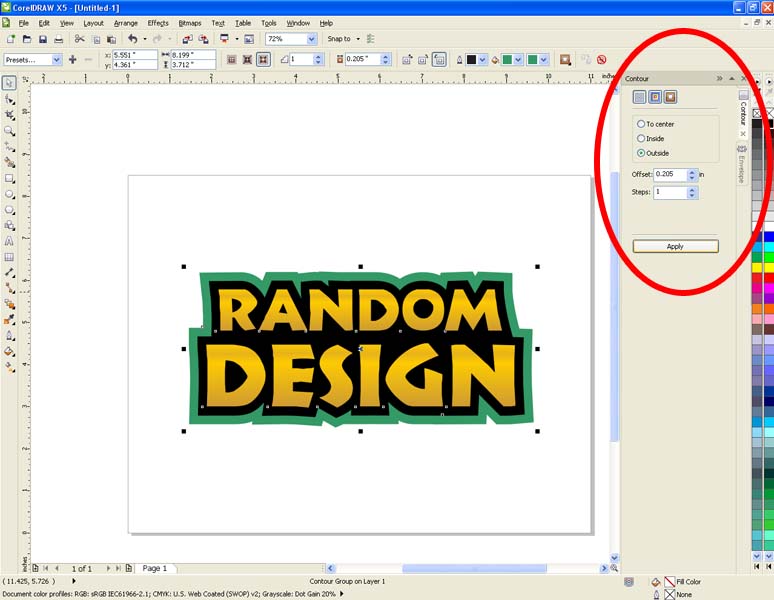

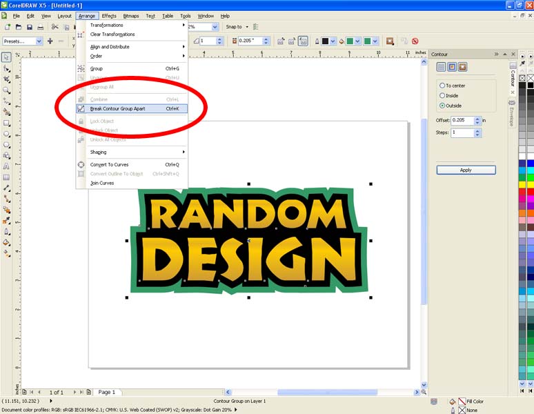

Had a few minutes, here are the steps for a contour outline in corel draw. step-1.jpg is showing group ... contour won't work without it. then go to effects -> contour and your contour tab will load up (step-2.jpg) do the settings you like, i chose green so I can see it. Then in step-3.jpg ... break contour will seperate it from the group. then you are done. probably take you about 30 seconds.
It appears as though in your screen shot the "outline" isn't an "outline" (like a stoke in illustrator) but is actually a contour, which is really a separate vector shape. "outlines" in Corel aren't vector shapes until you convert it into one. To do that you would go to: "arrange" > "convert outline to object" Contours are vector shapes, however you do have to "break apart" the contour shape and the original shape. To do this I right click on the contour and select "break contour group a part" Then you would be able to weld the two objects together.
To weld you need to select both shapes, the red box and the black contour, then use the weld command.
