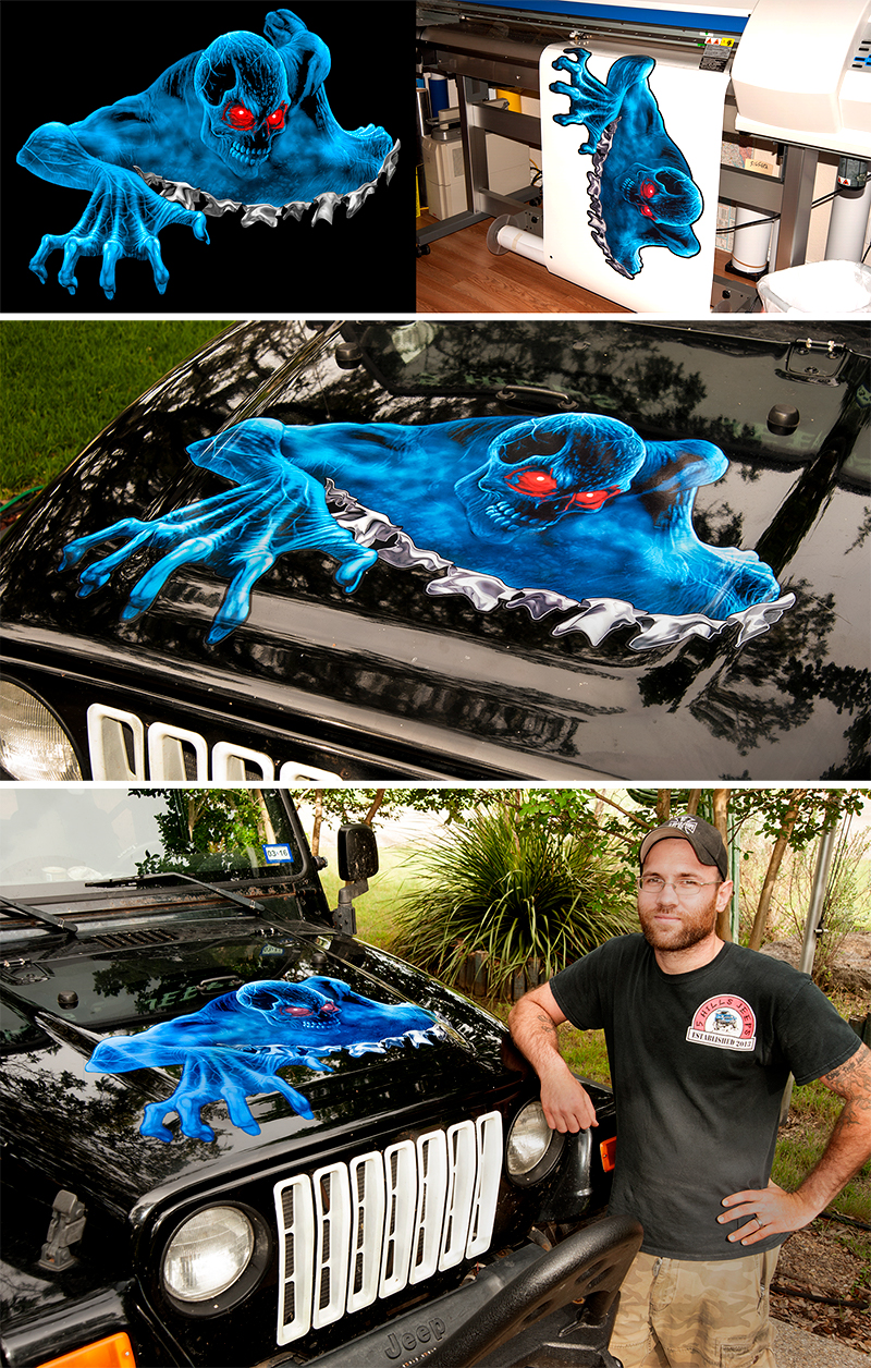

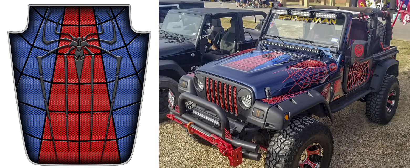

How do you ship large color digitally printed and laminated hood graphics with application tape applied?
phototec
How do you ship large color digitally printed and laminated hood graphics with application tape applied to the front side?
I was told to roll up the print with the image side facing out and ship it in a large long tube or box, however, when I rolled up the print the application tape buckled and wrinkled.
What is the secret to rolling digital and laminated print with application tape applied to the front? Thanks
