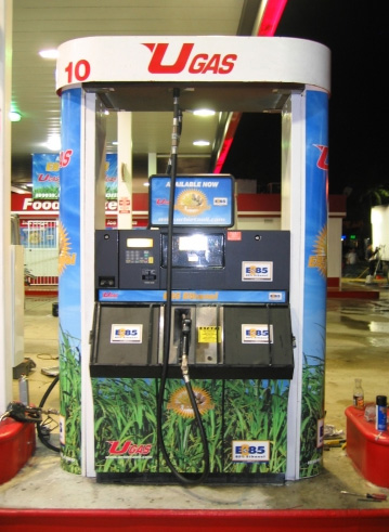

We have wrapped the fuel dispensers (diesel and gas side by side) for our local network of stations here for more than 10 years.
Same materials, same site, installed at the same time - diesel pump graphics fail first just about every time.
The diesel pumps always need much more cleaning when changing out the graphics.
I think it might be that the diesel does not evaporate right away like gas does so it has more time to effect the graphics and attract dirt.

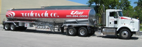

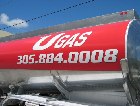

We had a client and did their BIG RIG fuel tankers. We used the ARLON 3420G laminate. It is not affected by gasoline. The tanker we wraps are going on 5 years and no problems.
check the technical specs - it has a resistance to gasoline rating.
http://arlon.com/Objects/Documents/PIBS/Series 3420S-3420G - PIB_LR.pdf
3M 8518 only offers a "resists petroleum vapors"

Assuming you used it with Arlon Vinyl.
yes we used DPF9000
DPF 9000 is a 3.8-mil, satin white, engineered vinyl with a medium initial tack, permanent adhesive. This digital film for solvent-based printers is recommended for applications where the graphic is exposed to high heat, solvents or petrochemical-based products such as gas pump skirts and vehicle wraps.
ZERO FAILURES.

Here are some pictures.
TIP: In case your wondering how we got it installed super super straight... We would start the install at the tanker depot at night. We would attach a laser level to the tanker and shoot a beam across it. then just mark it off with masking tape. then come back in the morning and bang out the job.
