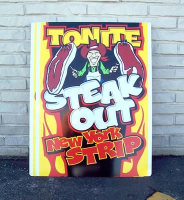

this is a members sign (great work too) how is the highlight on the letters done in steak out is that a font done that way or is it made,if so how
thanks shane
2B
its all about "layering" each "design" is on a different layer, so when you are designing you specify which graphic is on which layer. and that is how you get the effect you see

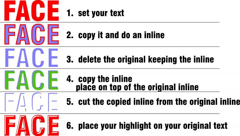

I did that in Flexi.
Set your type. CTRL+SHIFT+O to convert to outlines.
Go to Effects....outline. Set the pop up box to inline and make the inline.
CTRL+SHIFT+O to convert to outlines. Move the original type off to the side.
Select all of the inline and hit CTRL+M to compound.
Copy your inline, place the copy on top of the other inline layer and move it to where the overlap will cover everything you want to get rid of.
Select both inline layers, go to EFFECTS-COMBINE-CUT OUT.
What you're left with is the highlight.
Sounds difficult....takes less than a minute.

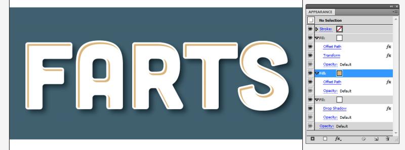

In illustrator, you can also do it "non-destructively" by creating another fill in the style layers, offsetting the stroke inside, duplicating the fill and adding a transform moving it... change the color of the shadowfill then just save this graphic style and apply it over and over and over and over....
omgsideburns
Here, I attached a screen shot of what I mean.. if you understand the appearance panel, you'll understand how this can be a great time saver and also keep your layers palette clean.
