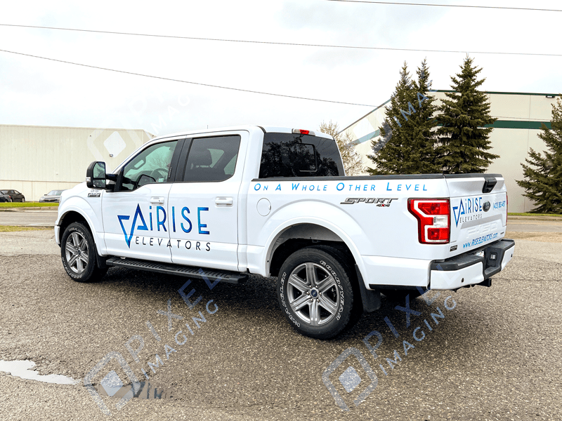

How long does it take for you to letter a truck from start to finish with spot placed graphics, including clean/prep time? No wrapping. Something like the pic attached. Just a fairly simple set of decals, nothing crazy.
30 - 60 minutes for install. We require customers to bring in their vehicles clean. If not we charge a cleaning fee. Cleaning time - depends on how dirty it may be.
Modern Ink Signs
About 45 minutes. I hardly use measuring tapes for this kind of work (too slow, and doesn't guarantee optimal positioning). Toss the panels up there with magnets, get a quick eye on it / adjust... then step back 20 feet to make sure it looks right and adjust if necessary. Aesthetics are more important than precise measurements.
The old eye ball method…smh
For those without a knack for it.. sure... it can be cringe.
As a graphics designer of 30 years, and a sign maker for 24 years, I can assure you I've got a well trained eye for positioning, negative space, balance, rule of thirds and all that stuff. I regularly tape up graphics by eye, then measure to see where I'm at... and I'm rarely off by more than 1/8" at full arm span. Many times on the money or only off by 1/16". In any case, the human eye isn't attracted to precision, especially on a vehicle with few/no parallel lines. It's about perception. You can measure the piss out of something for 10 minutes and try to make it to whatever YOUR idea of perfect is based on what... a PVO template you brought into Illustrator? What's your point of reference when a vehicle has a 'learn forward" position, very few, if any parallel trim pieces, etc. The ground? Is that the measurement YOU think is important? Again, perception. IMO, it's far better to step back 20 feet and actually LOOK at your work before you commit to the install. Unless it's a box trailer, F the measuring tape. Precise measurements are not the end all, be all silver bullet. When YOU are impressed by YOUR work.. that's the time to stick it. Make adjustments for what looks good... not just for your professional pride or your clients first impression, but ultimately the ROI the client will get from having an "eye-catching" graphic in a way that suggests artistry and talent were involved, not just "another print shop with a measuring tape".

Yup. I’ve done it before. 36 years of doing this I can tell if things are off by 1/4” or less
2B
Agreed on all fronts. Slapping it up and not actually getting measurements (and documenting them) is just sloppy workmanship. I don't care how good your "eye" is.
Yes, I can paste up graphics by eye-balling it and probably be 90% there, but I sure as hell aren't just calling that good enough.
Whether or not or customers want/notice/care if all their trucks are the same, doesn't really matter to me. It's called taking pride in your work and I'd rather be on that side than the "I can get it done real quick and cheap" side.
to add to this, by having measurements any future order (new vehicle or repair) can be duplicated and look consistent.
We have / take a print out of the digital proof and make measurements notes during installation, which helps when doing side 2, and then keep this on the account for future referencing
