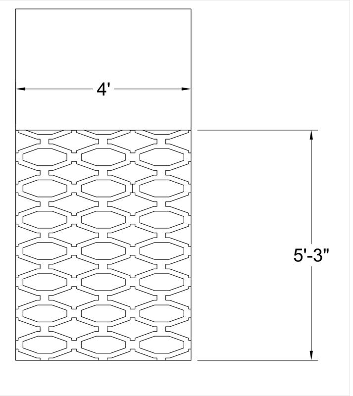

I don't have a CNC machine, and i'm trying to explain to a client that we don't just blink and have things cut out in a heartbeat. We are having our supplier cut this shape out of 1/2" plywood, and its 14, yes 14 full sheets.
So, those of you with CNC machines, would you mind giving me a ballpark time estimate and for these cut sheets? I want to go back to them and say Its wednesday at 4:30, nothing is approved, there is no way its reasonable to expect this entire job can be done on Friday morning, and I'd like some educated time estimates to back me up!

I'm not sure exactly what you are expecting to rout from that drawing but a rough guess would be 30-40 minutes each. Who is doing the routing...your supplier? If so you should ask them...if you need help...call me!

I agree with the 30-40 minutes. Could be longer if a 3/8" bit doesn't fit and a 1/4" bit is needed. Could be faster if you have a good machine that can crank out work. On top of the cutting time, you have probably around 5-10 minutes to swap sheets. All told, you're probably looking at 10.5 hours to do the job. Drop that on me on a Thursday to have done for Friday and I'm likely charging you rush fees because now my whole day is all you. I'd say you're looking at a minimum of $120/hr.
Also, as an aside, I would require you change your design to be narrower than 48". As a general rule of thumb, anything CNC cut should be less than 48" if you're looking to use a 4x8 sheet. I recommend 47" as the maximum.

One hour each piece at least after you figure in all the other time associated with it.
Why rout that out of plywood?
Looks like it's going to be a fragile piece

dear God route that out of pvc! what in the hell are people still using plywood and mdo for?
time for my guy could route one in 25 minutes per out of pvc

If they want it to be wood grained. Also PVC doesn't cut faster than plywood. At least not in my experience.
I did simulation in my software. Plywood with 6mm bit at 150 ipm 23min PVC 6mm 200 ipm bit 20min. Inside pieces large enough for my vacuum so no tabs. To change sheets and clean a table 10-12min.
fixtureman
I also did a simulation and I get about 20 minutes to cut and about 15 minutes to clean and reload so about 30 minutes per sheet. remember you have a to allow for employees breaks and lunch.

I just have a Shopbot but I run a $300K Biesse at work both can only run so fast using the size bits that it will take to do this job. So the big expensive router doesn't matter.
