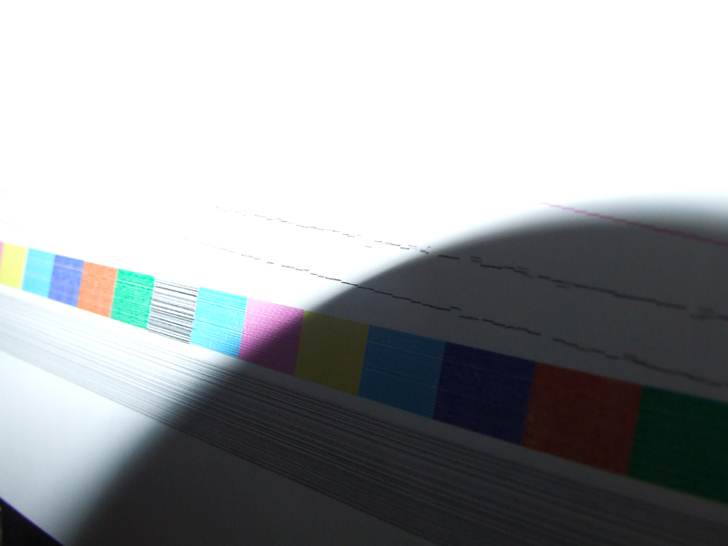

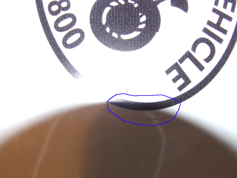

I have a Mutoh Falcon Jr outdoor (rockhopper 38) and have been having problems with black lately. I am getting banding and random dots. I have cleaned the nozzle, let it soak over night and still nothing (well a little better). Just redid the tubing on the pump, thats working good, all new dampers, all new drain lines. I tried reading my manual to adjust the spray but its like gibberish to me(doesn't help that its translated from german to english). Any help? Or do you think its just time for a new black printhead?

Probably your black head is out of adjusment. If you could post a picture of the nozzle check I should be able to tell you.

I am very interested in the outcome of this, as I am still having the same issue. Bet you have deflecting nozzles.

As you can see with the red line up in the corner, colors are printing fine. The black is all over the place
