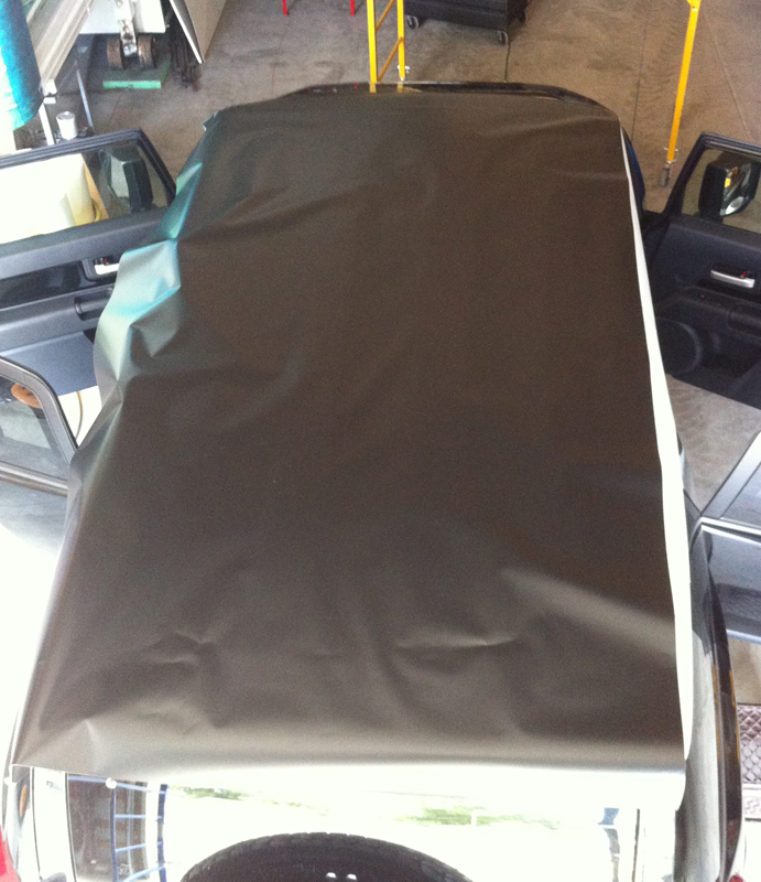

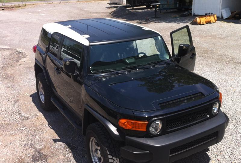

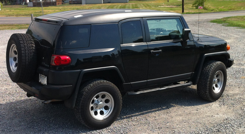

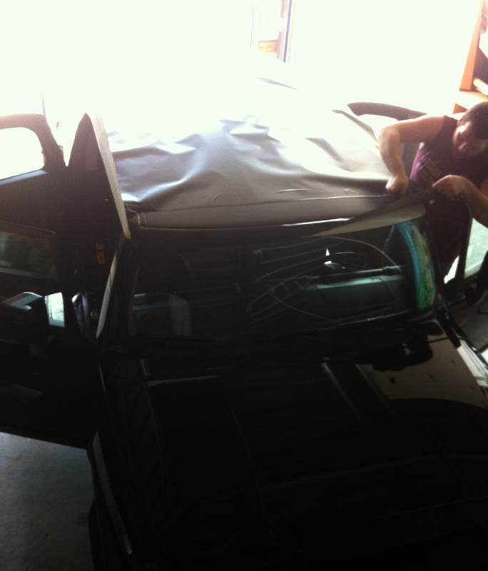

We just did this FJ cruiser a couple of weeks ago using the 970RA. I found it very easy to work with. I worked on one side of the car and my partner worked on the other side. we peeled back about 18 inces at a time and completed it before peeling back more.

Have you ever done a wrap before? The roof is relatively easy. Just take it slow and peel back the liner as you go. Don't try to peel all the liner off at once. Make sure you keep the material flat. I have done two by myself and they go pretty easy.
Probably a stoopid question, but ucm, what are those white squares on each side of the roofline ??
ucmj22
I made cut outs where the roof rack sits using knifeless tape. I thought it would be less likely to fail that way instead of wraping it in to the holes. once the roof rack was put on you couldnt see any white.
:thankyou: I never thought of that. With wraps, we don't do much of that kind of stuff so it looked odd to me. Most of our stuff is just commercial and industrial. That little tip will come in handy.... thanks again !!
