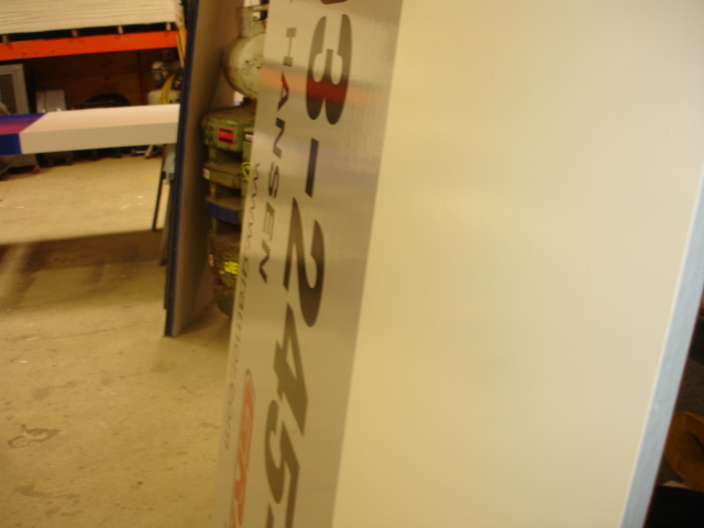

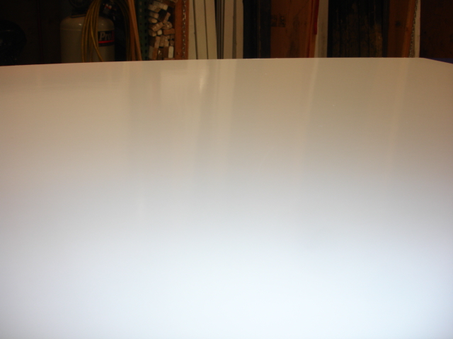

I've never tried it that way. I'm sure there is a bunch of ways to make it look good.
Our way takes only 1 coat of primer and 1 coat of paint. Take a look at the pics...... 1st one is of a white board (oil based paint) and the 2nd pic is of a yellow / grey (water based paint). It's all in how it's applied.
I have to be carefull who I tell. My compitition is dying to figure out how we get our boards so nice.
