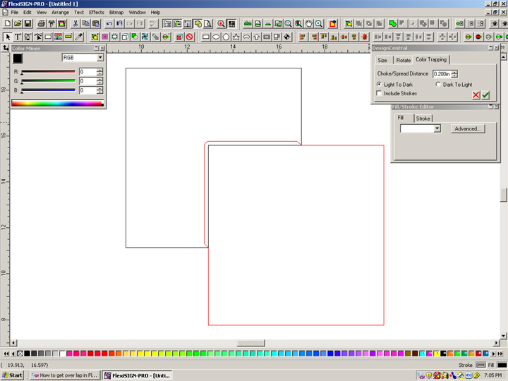

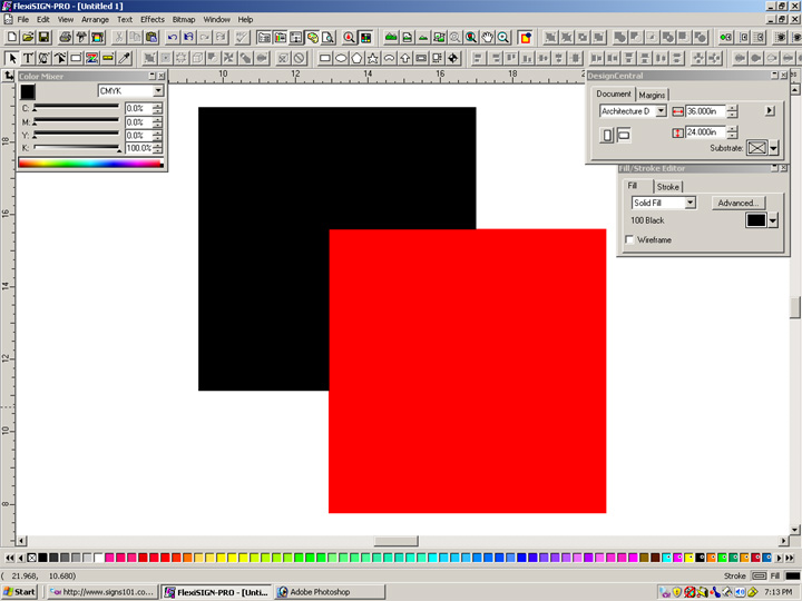

The color trapping tool looks like it would be very effective when you have objects that overlap in partial areas. Work with it a bit and you'll quickly see how it works. Here's a sample with two overlaping objects, one black one red, select both objects then apply color trapping, see attachment.
When printing you would print the red first (lighter color) then the black.
