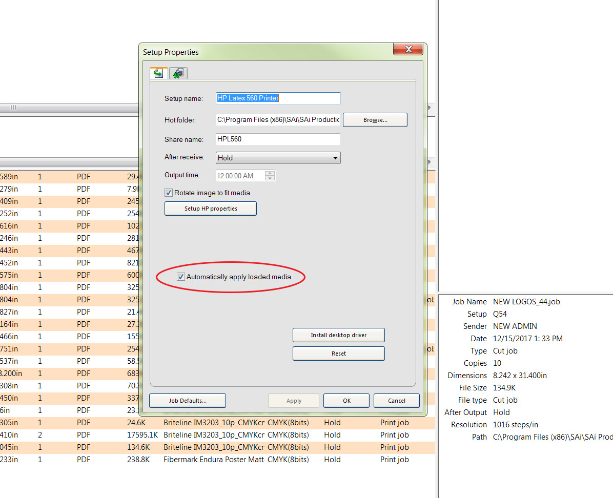

In Production Manager, Click Setup>Setup Properties, then check off "Automatically apply loaded media".

Well that's the only place I know of that will do that. There will always be a 'default' material setting in the Default Job Properties, but having that one box checked will always cause a pop up after you load your material and select it on the printer. It will ask if you want to load this material and size for the next jobs you rip. So make sure it has a check and then hit APPLY afterwards.
