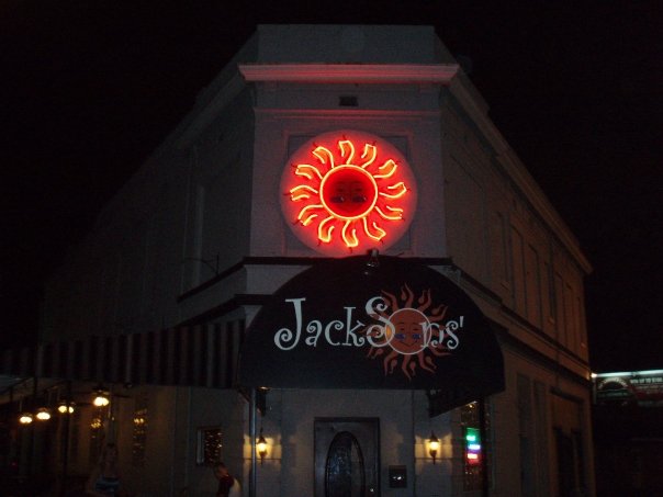

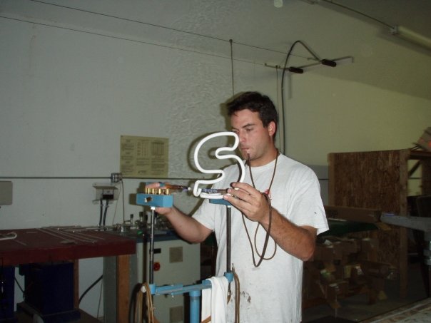

When our son turned 20 he developed and interest in neon. After a month of intense hands on training from an old local neon bender he had enough continued interest so we purchased a euocom system. After 8 years he is still learning. He devotes about 10 hours a week to neon repair and new projects. As far as I know we are the only shop that offers in house repair within a 100 mile radius. It is a skill that requires lots of practice and patience, but one he will have the rest of his life.
The Jackson's sign was one of his first, 8 years old and never needed service.
And of course thats my baby in "action.
