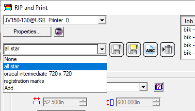

There has to be a way to do this as mine always defaults to none. I made my own preset and want it to be used without me having to always select it. Is there a way?

Sorry maybe preset is the wrong description. I have attached the menu item in rip and print

Whoops I forgot a step. Go the the setup menu and click default job properties. A window will pop up like a normal job. There you can setup all the settings and there will be a button in the bottom right corner to set the default.
