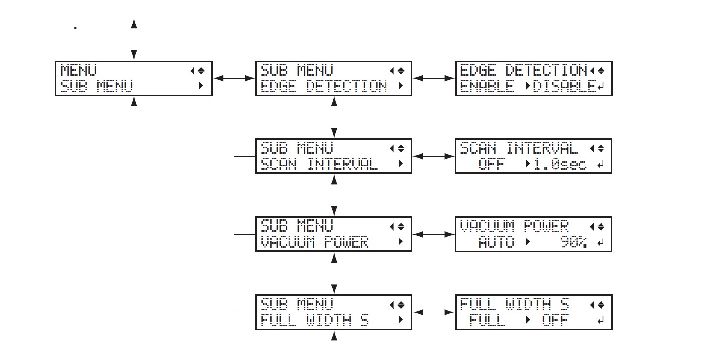

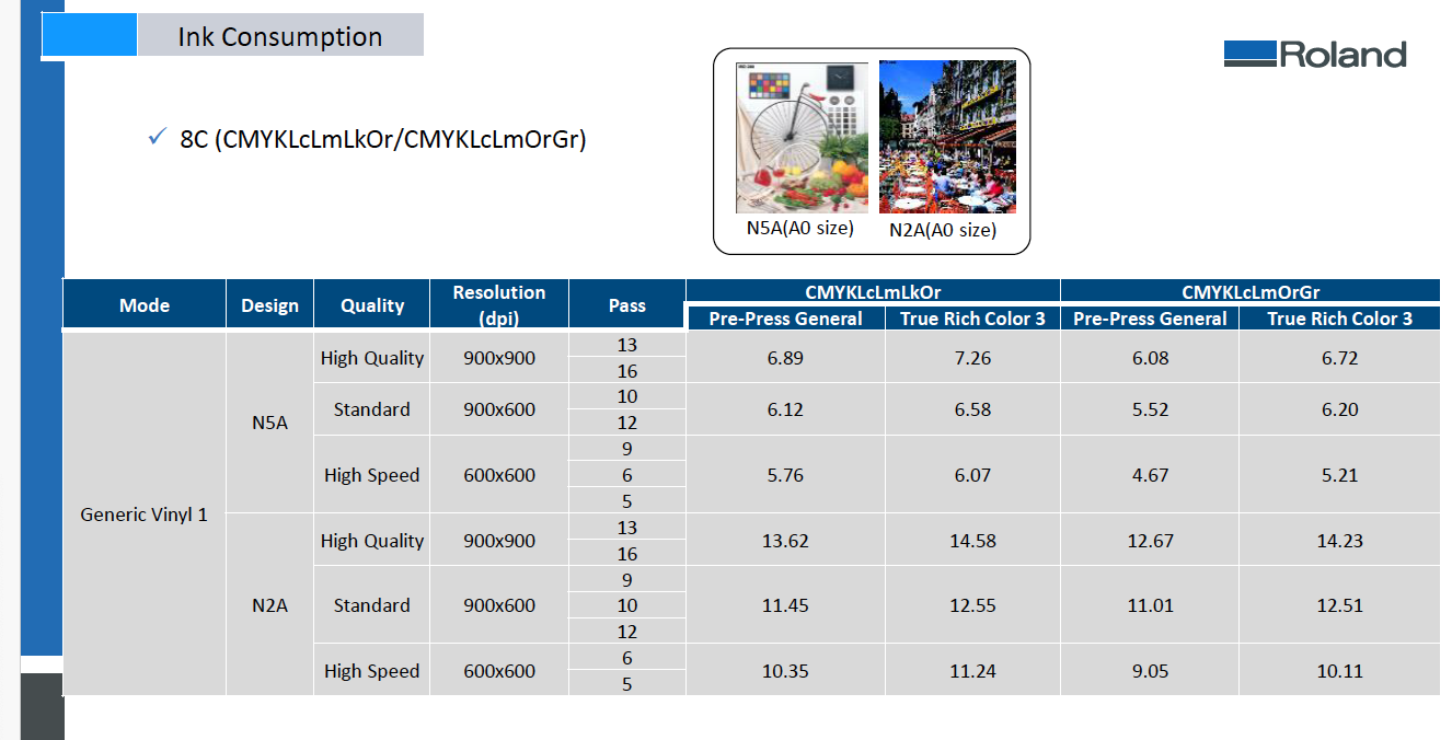

Hi Jim thanks for your long answer. This will help too. But i also need another option which is: when i print with xr 640 print heads not going all the way its stops and get back to print again... i mean if the print file is 1 metre.. print head only goes 1.1m then go back to starts.. But VG3 print head travel 1.6 even the prints are 600mm wide... If you understand my question do you have an answer for this ? Thanks
Jim Hancock
Old School Technician
Here you go. It should speed things up considerably, at least on files that are smaller in width...
