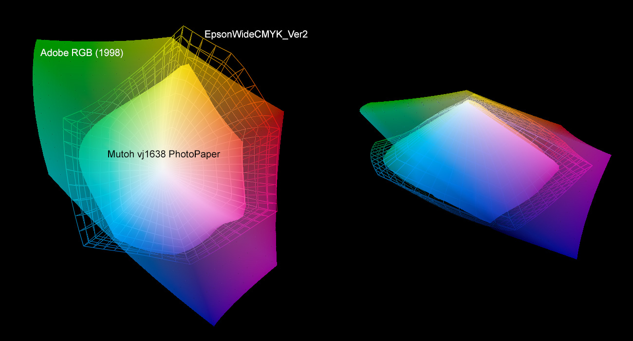

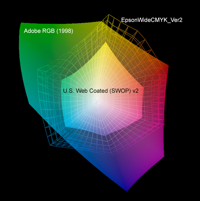

However, it is misconception that RGB is a larger color gamut than CMYK. It depends upon what RGB space one is considering against what CMYK space one is considering. For example, both Adobe 1998 and sRGB can be deficient in cyan colors against certain Epson eco-sol printers.
Designers need to have any and all working space profiles and output space profiles at their disposal so they can create colors which match among their intended targets. Unfortunately that's usually a lowest common denominator such as sRGB for websites on older monitors and CMYK only printers. It's then often required to sacrifice cyan gamut that a good CMYK printer may be capable of but sRGB (even Adobe 1998) can't reach, and also sacrifice warmer colors that CMYK might lack but the two common RGB spaces can reach.
