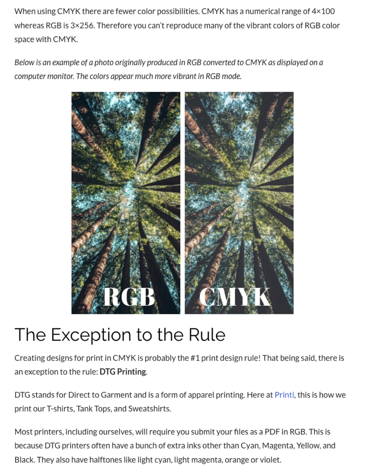

You can see even some print suppliers online will say only send us PDF's in RGB. There is a reason they don't want CMYK print files. Last time I checked signs365 was one of them and I will attach a DTG supplier screenshot as well who is still WRONG that DTG is an exception but in general overall they are right in why they also say send us RGB PDF's only.

Not to be a dick, but how does this have anything to do with OP's question?
He wants to print in pure C M Y K... As in a pure cyan square, a pure Magenta, etc.
Why? Maybe he wants to see if one of his heads is having a problem... Maybe he wants to test for ink starvation... Maybe something else. But it doesn't sound like he's trying to hit a color not in the CMYK spectrum.
