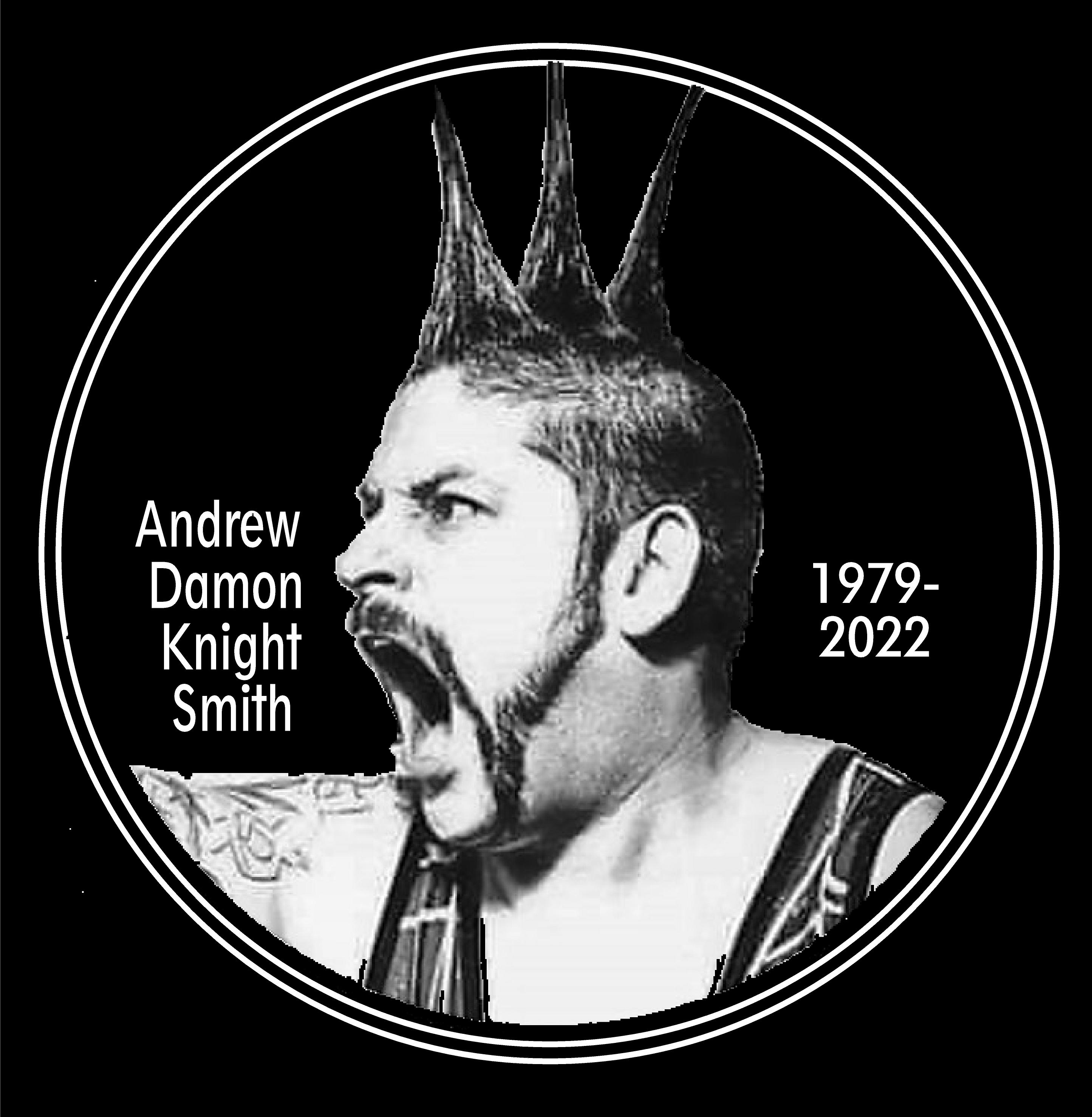

How to screen print this
Stacey K
I like making signs
White ink on black shirt OR should I do a full color transfer? If I screen print this, how on earth do I do the photo?
* Yes, I understand the design is not complete ---- I need input on the photo, not the rest of it. Thanks in advance!
Just pull out the black? I really don't know, it's been ages since I've had to design T-shirts for screen printing.

I use pretty much the same method as the guy in the video. This image would be relatively easy to make a positive for in photoshop IMHO. This presumes you don't have a RIP to generate the halftone. Once you've done the work to get the photo halftone, open the original back up and copy a layer over with the circles and text (or just redraw it, LOL)
I generally do 65 lines at 23.5° in an ellipse shape. Play around until you get settings that work for you, this works for me on a 230 mesh for most images. Just remember that you're working in reverse, where you have black on the positive is where your white ink will print.

Stacey open up this PDF in photoshop. As is it shows what the output should look like on the shirt. If you hide the black background layer and turn off the white color overlay on the other two layers, it should be ready to output for your positive (presuming the line and angle work for you for your screen.) If it doesn't work and you want it modified LMK. It literally takes me about 3 minutes to do this and happy to help. :cool:

I'll have to try this, it's definitely NOT something I usually do. My apparel business is mostly 1-2 color easy stuff. I told the guy we can do it in color and I'll get the transfers from Supacolor. I reset all the other stuff so we can make it white circle/words ink and the photo in color. I was stuck and time is running out for this project. Cost a bit more for the transfers but it's for a benefit so each customer is paying separately at my price then he added $5 to each shirt and hoodie that will go the benefit.
At any rate, I need to know how to do this so I'll try your advice, thank you very much!!!!
