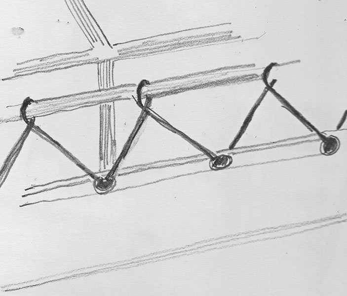

since the SUBSTRATE that will cover the frame is approx 20 feet long, what piece of equipment do i need to acquire, or what technique am i not getting that allows me to AFTER FASTENING THE TOP, stretch the 20 running feet of vinyl TIGHTLY, EVENLY, WITH NO WRINKLES?
i have been visualizing how to fabricate a fixture that will allow holding the substrate in place [ if i do 5' at a time] while fastening it (OBVIOUSLY I WILL FASTEN WITH THE SAME TYPE OF FASTENERS THAT ARE CURRENTLY USED)
Johnny Best
You have to lock stich lace the awning back and pull down and sideways to pull tension and get wrinkles out. You can buy rope from awning company to accomplish.
