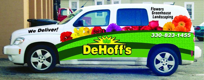

I'm having a heck of a time approaching this partial HHR wrap because of the door handles. It is a 4 door. I'm reprinting a section for the left rear door now because I just slapped the vinyl on the whole side and struggled so much with the door handle that I got unacceptable wrinkles in it. No problem with the rest but haven't wrapped around the the front handle yet.
All the texts are separate. The bumpers are not to be wrapped.
If anyone has any idea of how to approach this problem I'd really appreciate it.

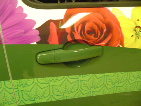

ddubia
Here's a pic of the wrap on the handle. Not so bad once I got a little advice from here.
I really don't wish to be a thread-starting machine but since this is our first wrap (partial) I'm posting pics of the job in a new thread.
