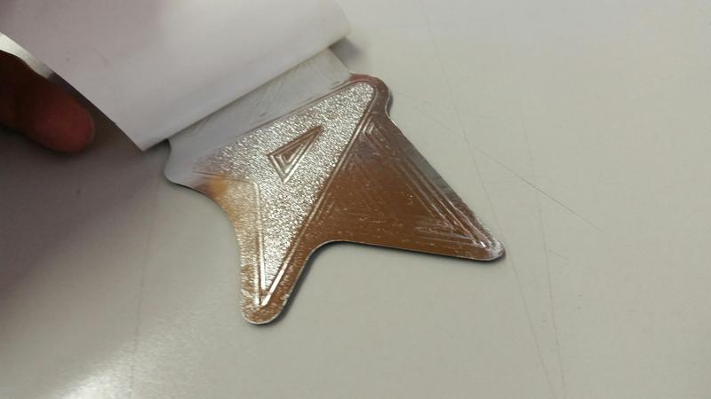

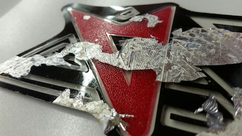

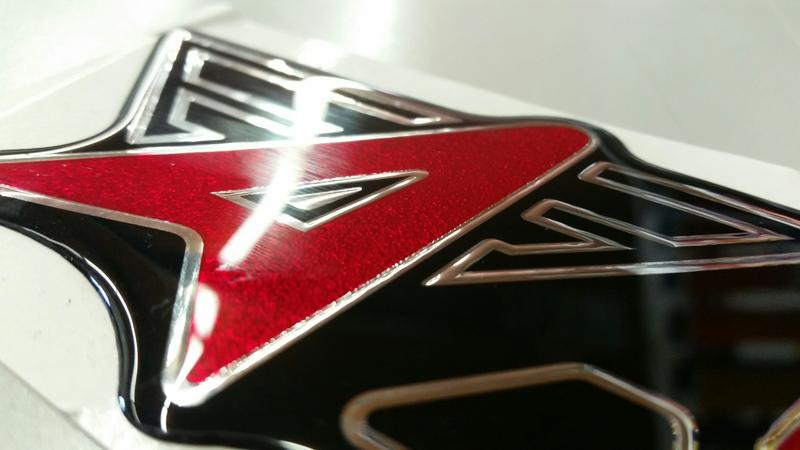

Have a friend that asked if we can dome some vinyl letters for him. Yea, that's not to hard just let me know what you have in mind. So I get a package with the attached NOS decal that is no longer being produced.
It has to be thermal printed but not sure how. Are those Summa or Gerber colors, it has chrome on the bottom or base layer but not sure how they got the metal flake/texture in the Red.
He also sent 2 other molded badges that need to be converted to vinyl but he wants the same look and colors for everything.

I know it's doming and we have done it plenty in the past. My question is what equipment was used to made the Chrome, Red and Black graphics part.
Can that look be achieved by a thermal printer? And if it can is there someone out there that can get close with the Red effect?

I don't have a thermal printer, but i'd actually guess those were screen printed.
I don't screen print either, but I'm pretty sure you can get translucent ink, which would show the flake through.
I would second the screen print. Many of these type of stickers are done in sheets. Screen print the sheets. Cut and weed. And then to a table and a doming machine. Doming machine is usually setup to do multiple stickers on a sheet at the same time.

You could make these with a Gerber Edge, however I have no idea how they got the metallic flake in there that way.
I would bet our Epson here could make them also if we had chrome vinyl and patience testing it out, as it has the metallic ink option.
I would suggest a solvent printer with spot metallic inks, plot and then dome them. Good luck!
