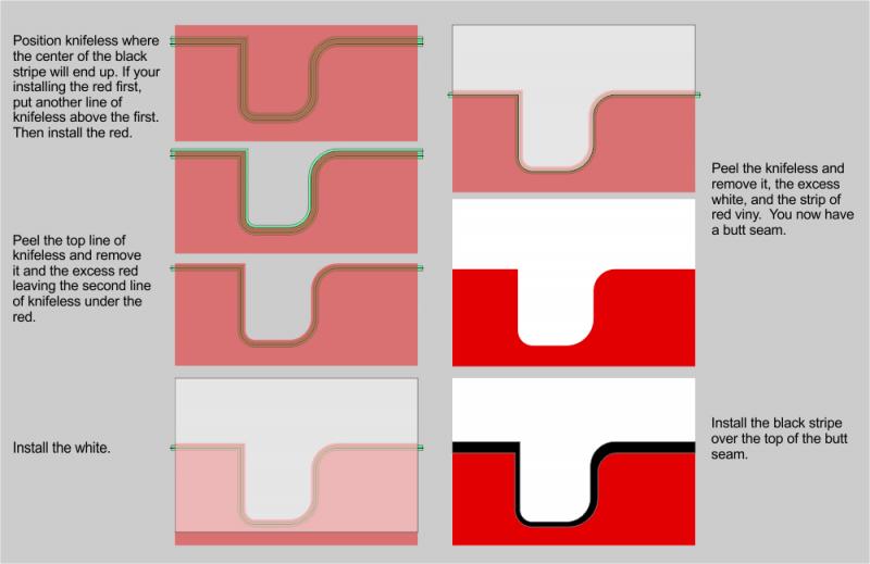

Looks like you and your customer designed yourself into an difficult situation. If you contract with quality installers you might contact them for advice. They will be the ones installing it and the method should play to their strengths.
Looks like you could do the cab normal and the bed with knifeless using the process below.
MikePro
print/wrap the red&white.
overlay black vinyl & knifeless tape for your pinstripe/outline work.

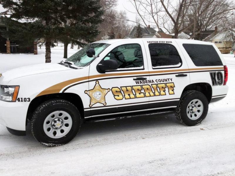

I print these as one horizontal piece and cut the top line with either knife less tape or with a razor. Even the white stays on the vehicles.
