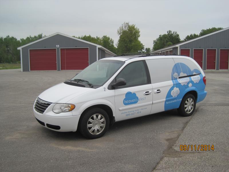

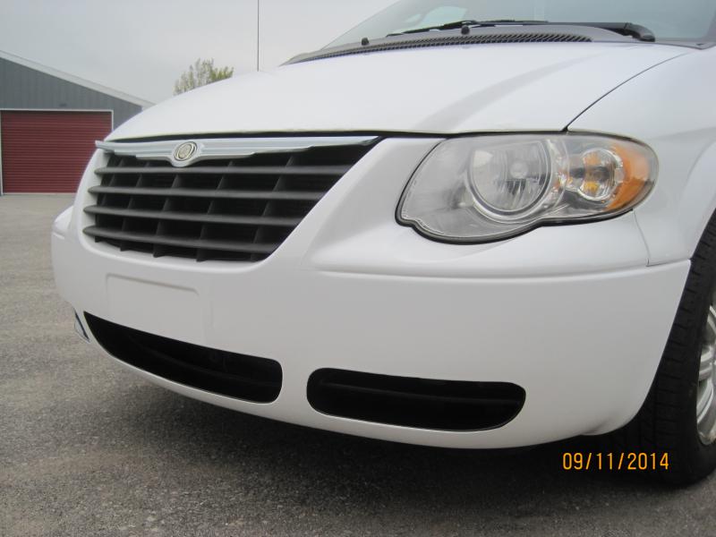

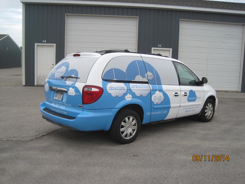

Hey all. I've been in the sign business for about 3 years now, and in the last year I have pretty much taken control over vehicle and trailer wraps in our shop. We average 2-3 a month. I feel my quality and completion time is great for my experience, but sometimes according to my co-workers, it isn't "fast enough".
We just completed a job for a local daycare where we wrapped 4 mini-vans. A Chrysler, 2 dodges and a chevy. All had the same artwork and the vans were all the same size within 5-6" in length. All vans were different colors, and were complete color change. 3/4 had painted bumpers, trim and door handles which were all wrapped also.
Not including clean/prep time and not including the view-thru, I averaged 18-20 hours of labor per van (just me). The van in the pictures attached was originally dark blue.
Please provide me with some feedback, positive or negative! I came from a world of body work so patience for wrapping almost comes natural, but now that the vinyl industry is my career choice, I would really like some input on how long this should take a skilled wrapper with years of experience. Is 20 hours of labor pretty good for someone with my experience doing these by myself? I know I will only get quicker, but at this point, quality is what I'm shooting for.
Wrap was printed on 3M on a Mutoh 54", Oracal 290 lam.
Thank you for your input!

Man, for that kind of job by yourself I would say that's fine, especially with your experience level.
Like you say, focus on finish and over time you'll speed up for sure; customers (most) are more concerned with a good finish than the difference of a day or so in installation time.
- James

+1 a quality job will always out way the completion time.
with that said you have to stay competitive on pricing and as you get more experience so will the speed.
Very nice work.
As for the time frame, ya gotta do what it takes to get the job done right. If they are upset with you, have them do one and show you how to improve yourself.

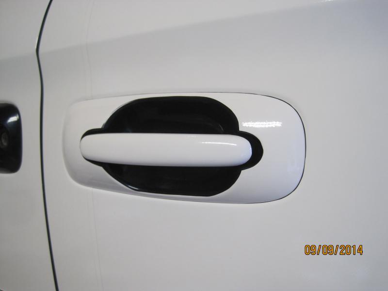

While this is way better than I could ever hope to do, I gotta ask, is that the accepted way to wrap the door handles? the paint showing through around the handle sticks out like a sore thumb to me.
as for the time, it sounds fine, there are some people on this board that would wrap that in 3-4 hours by themselves, but they have been doing it for years, keep at it, you will get faster.

First of all. Excellent quality on the install. Very impressive for someone without a lot of experience.
As for the time 18-20 hr is a very long time. For our shop that's a 6-7 hr install.
If your shop owner is charging for the customer for extensive install time it isn't a huge problem.
But in a high production shop those install times would be a problem and huge bottleneck.
You're on the right track. Keep at it, and you will get faster with each install. Good job.
Also be careful mixing vinyl and lam name brands. It voids all warranties.
Three to four hours? I'd like to see that! Complete color change? With those bumpers and side moldings? Hmmmmm.....

watsons signs: I'm not sure if this is the "accepted" way to wrap handles, but these are honestly the first door handles I've wrapped. Every other vehicle I've done has had un-painted (textured plastic) handles.

Makes me want to cray seeing a seem so dang close to the edge of the door (in handle photo)
As for your 24 hour install (in, prep, install, out) for 1 person...compared to how much they should be making per wrap...should not be a problem.
you say 3-4 a month...that's not a high volume shop.
Those high volume shop guys in here that talk about running cars in and out as if they were a drive through...typically have multiple installers and preppers working on them at a time.
As for wrap installers...beggars can't be choosers. Quality is hard to come by. Quality and speed...even harder.
