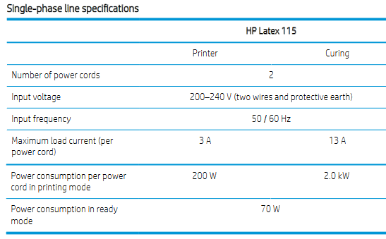

So the 115 needs 16 amps. According to the stats on the device, it can do 16 amps continous... so it should be ok. But again - I'm not an Electrician... I dont know how reliable these are! And a big point you may not realize... you cant plug it into any 2 outlets... It has to be plugged into 2 outlets on a different breaker. So you'll have a 20-30 ft cord running from one room to another room, and most likely both of those rooms wont be able to have anything else plugged into them while the printer is running.
16 amperes, continuous; 20 amperes up to 3 hours; momentary over range to 50 amperes for starting motors and similar demands.
