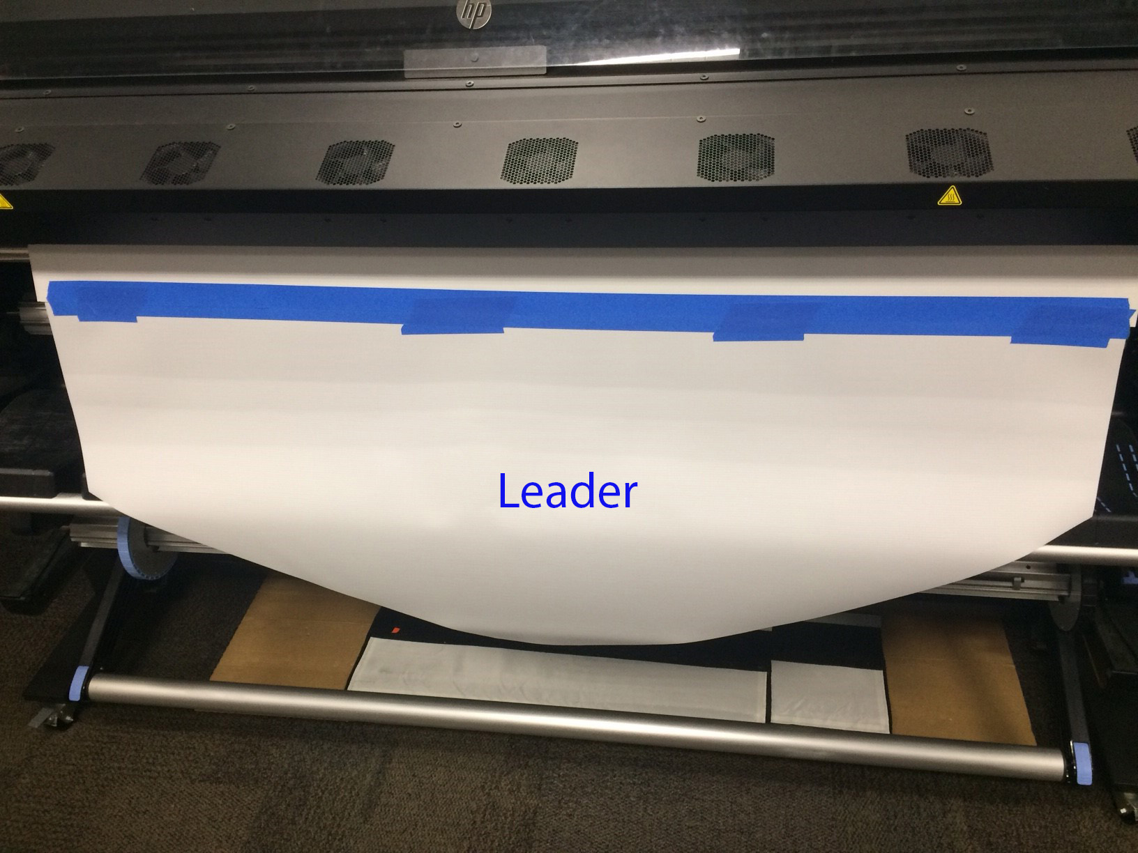

Re the waste: use of a reusable leader would bring that lead-edge waste to near 0, s you can consistently and reliably print to within inches of the print media's front edge, while the leader provides the forward tension that minimizes the potential for crashes.

For our cheap material we just waste a foot.... never 2 Ft. For our expensive material, we do what P.wagner suggested and use a leader - Some material we find will get strikes unless it's on a take up reel...
So we have a few empty cores of various sizes with 4-5 FT of end roll material on it - We just load that core, tape up the end to the vinyl and away we go. In reality it doesn't take any longer than waiting around and attaching it to the core once it's ready to go, so it's worked great for us. Almost zero waste at the start of jobs.

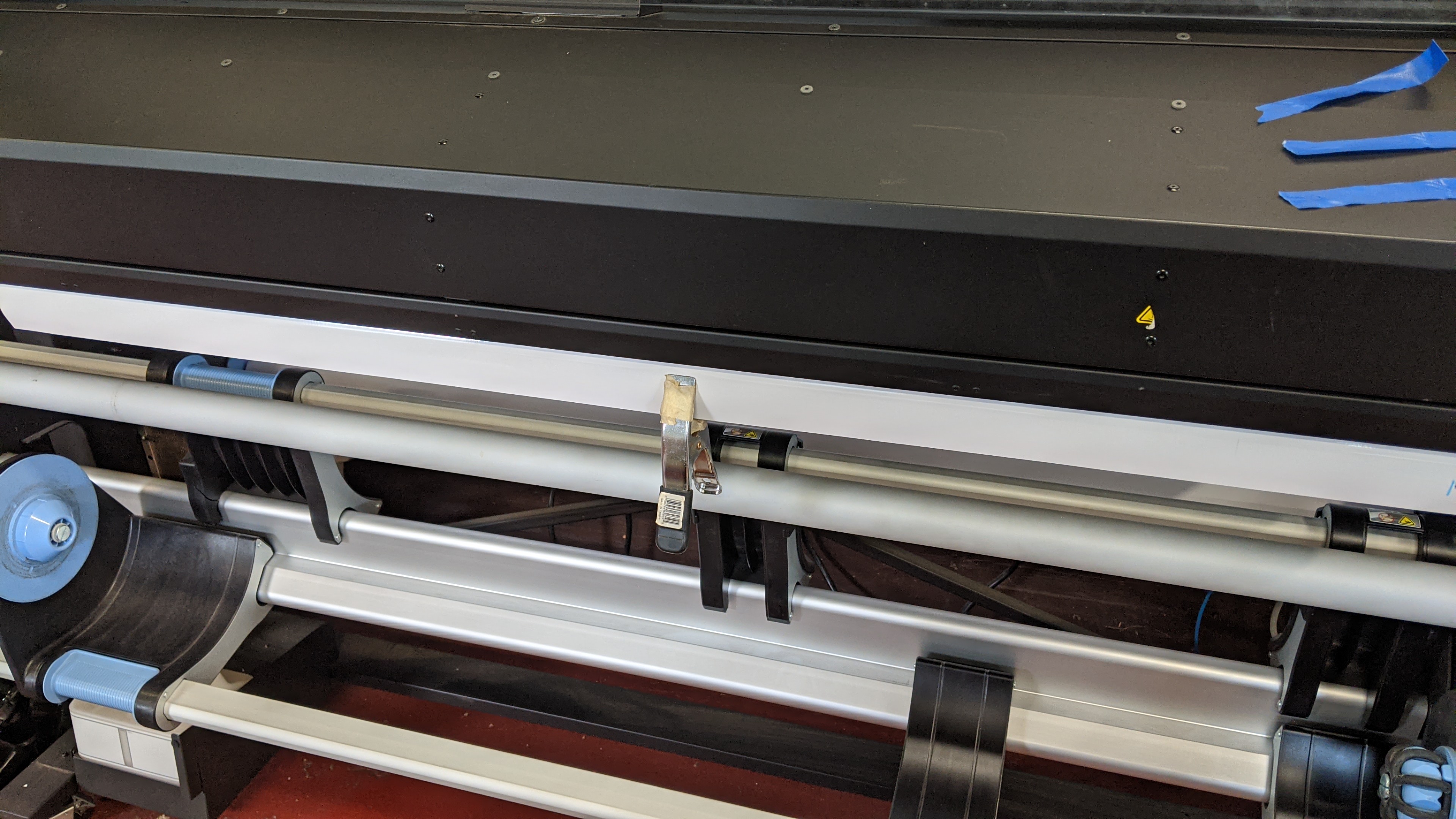

We have a 560 as well as 1500s. If you really want to get some vomit in your mouth..we thread up 6 ft of material on the larger latex printers just to go roll-to-roll. We have at minimum... 3 ft of waste on those for anything from 54 inch paper or SAV up to 126 inch banner. As stated above, we maximize material and job runs as best we can to use the most material from the roll. Nesting jobs and even upgrading a small economy job to a premium substrate at times helps with waste reduction.
On the smaller latex printers, we found that getting the material out from under the heater door initially and attaching a spring loaded clamp on the end of the substrate can work. It gives it some weight and tension. As long as you have tape and a core ready to go, you can minimize some waste there. Downside is you have to hang around for the printer to get to the point where you can tape it on and make sure all is ok before walking away.
