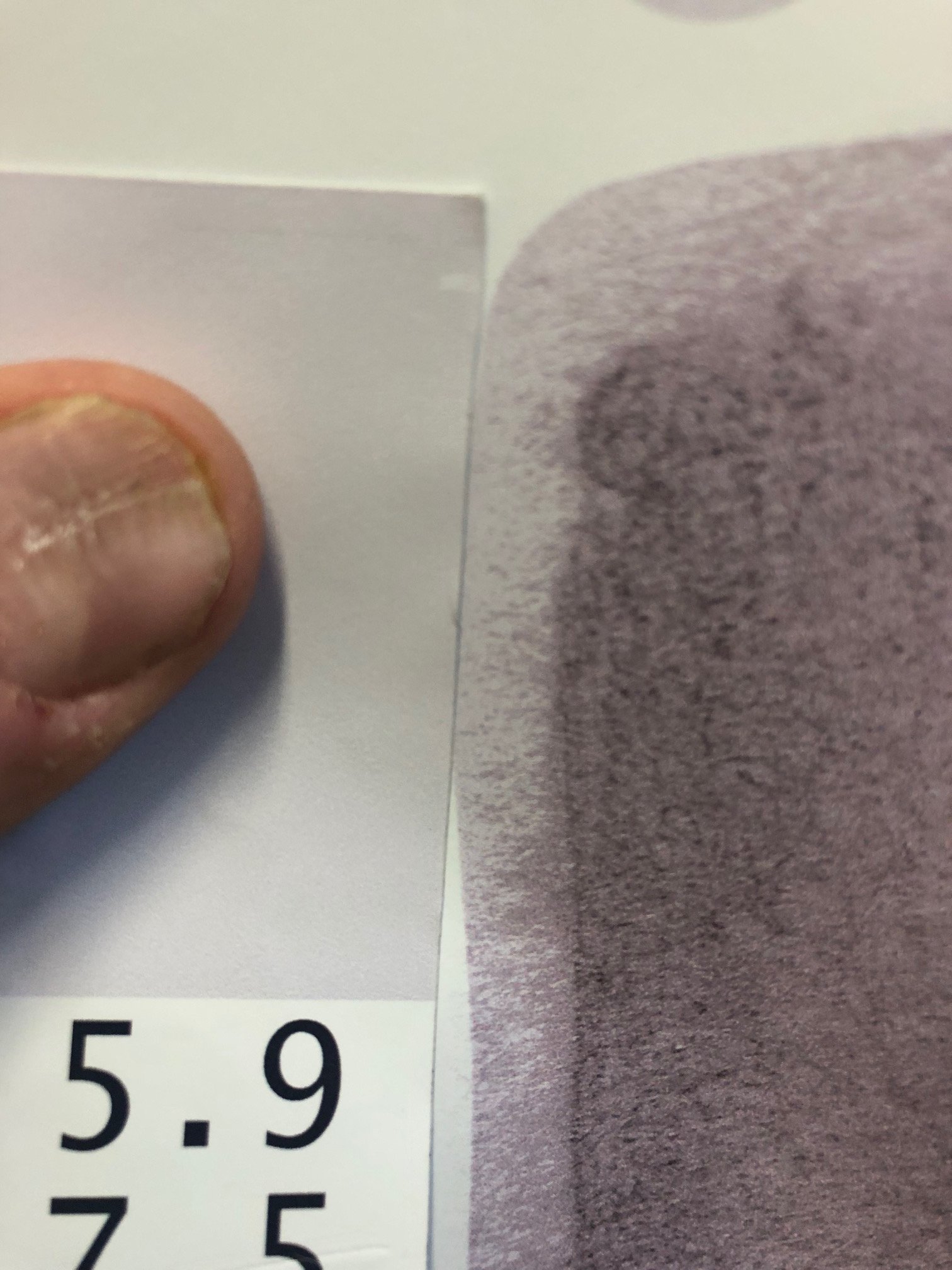

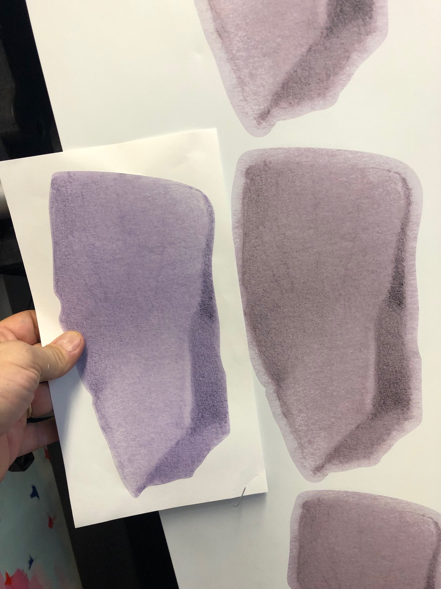

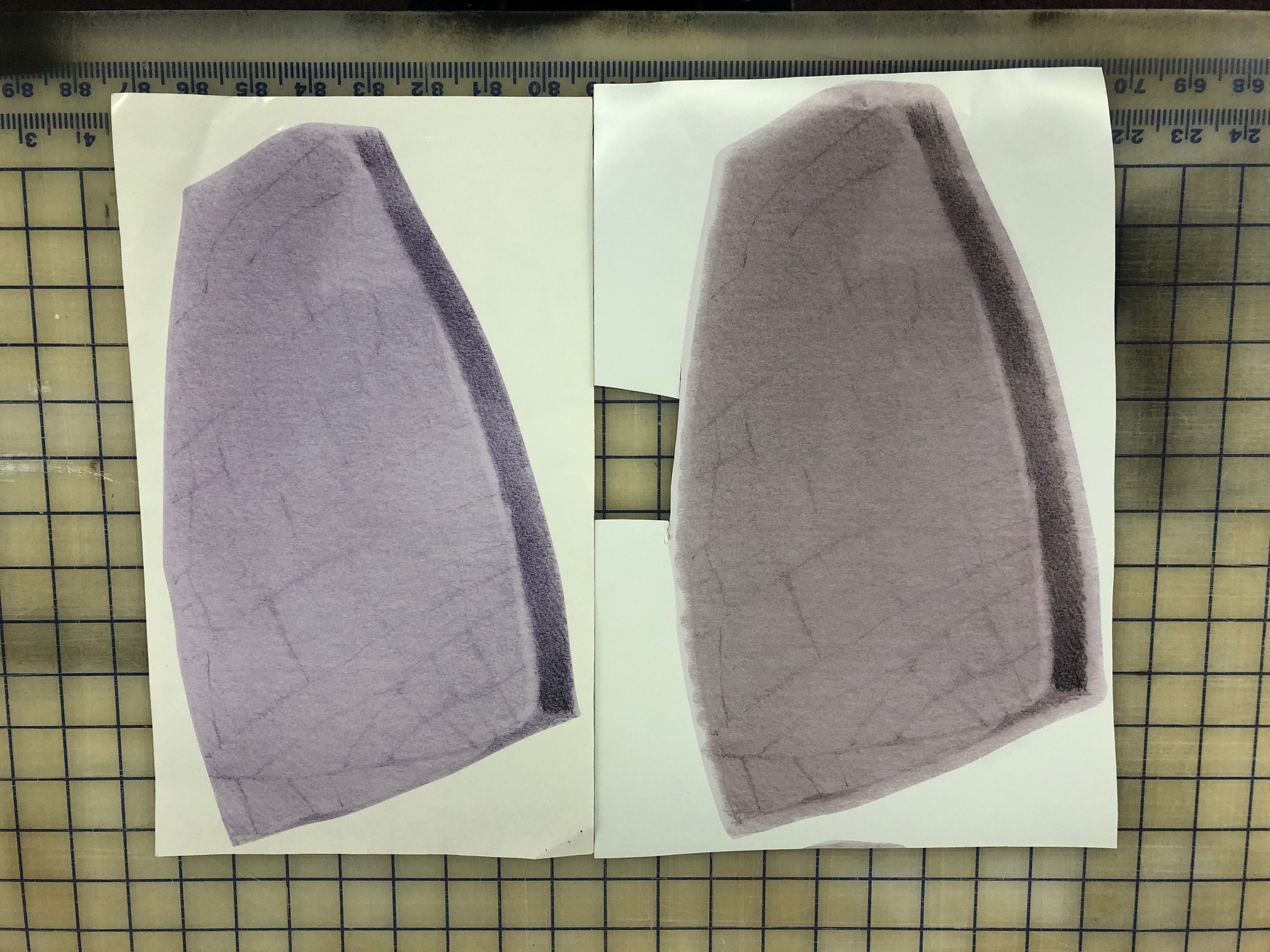

I have an HP latex 315 I am running ONYX. A couple months ago I printed about 2000 stickers for a client on 3M ij35c. The bleed border and base (lightest parts) were color matched from the color matching system. The overall image came out perfect and had a purple tone to it. Today the client reordered these stickers and the prints are now printing with a grey tone but the bleed border and lightest parts are perfect matches. It is almost as if the print has lost all its purple and is just printing an entirely different hue...
Things I have tried:
different recipes
kicking up the M and C
tried as jpeg and tiff
tried a different roll
Whats weird too is that on my MAC its purple when viewed in illustrator. But when I view it in a preview window on the Mac it looks grey and it looks grey in the preview windows on the PC running onyx.
HELP!

It's a print head issue. Replace the printhead. Run the cleaning and tests, then check which needs replacing.

The white point of your media seems to be different in your pictures. Could be the cause.

Yes did a color calibration, 2x. And tried a new roll of 3M. In the end I used the "all ICC profiles off" option in Onyx and it printed way better, but this only seems like a bandaid. Originally these prints came out great using my 3M Ij35c profile (out of the box from 3M profile), but a few months later the prints came out soooo different. I am totally stumped. The different white points are one has backer paper the other does not.
