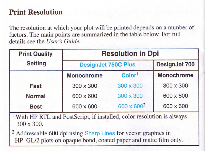

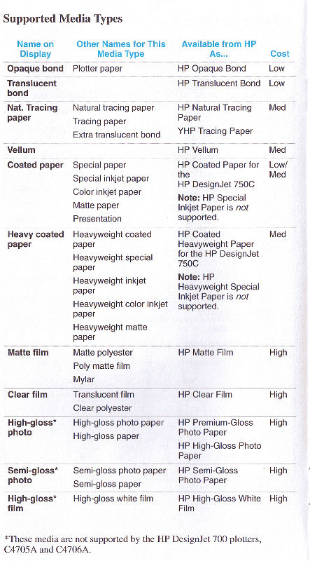

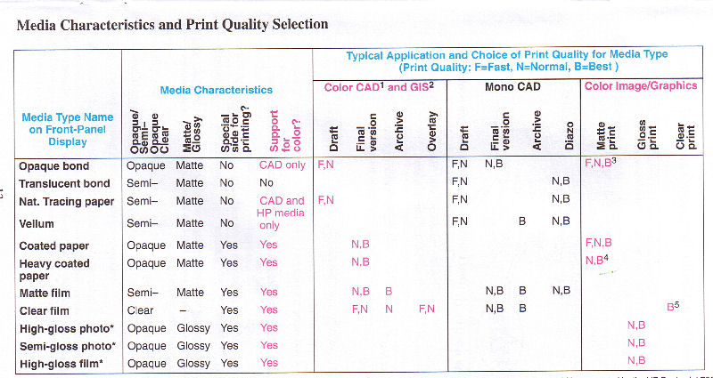

In the quick ref guide it has the following charts. Like I said, I have no experience with large format printers, I just got excited when I viewed the charts. I scanned them and have attached them.
