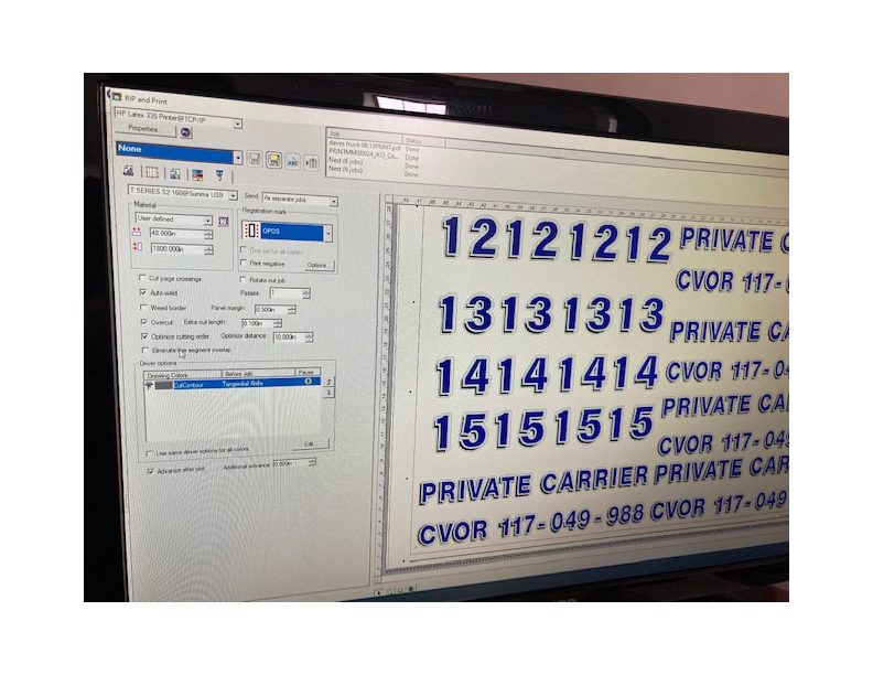

I have been trying to find the option for Horizontal / Vertical Weed lines in HP FLEXI SIGN & PRINT. When I check the help menu it shows the option in the CutPlot dialog Box Option Tab. But in my version the only option showing is Weed Border. Can anyone help? I have attached a screen shot of the dialog box.

This functionality is available in cutting output only. Among other things because weeding lines could cut through printed areas.
