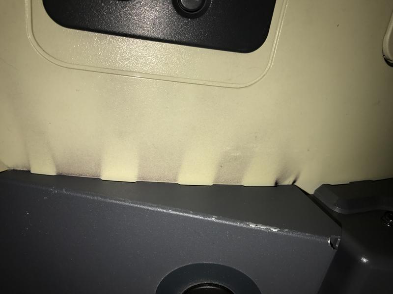

I was wondering if you did the alcohol swab on the print head contacts in the carriage. I do them about every other time I change heads. There is an unreal amount of aerosol in the printer that you never see. If I can attach a photo, you will see a bunch of ink deposit on he exterior of my printer from running it when I had the exhaust fan out for replacement. This thing is a dream for techs but not so much for everyday printing. I have broken mine down 4 times for misc stuff that I was able to replace or fix myself at a fraction of what hp wanted.

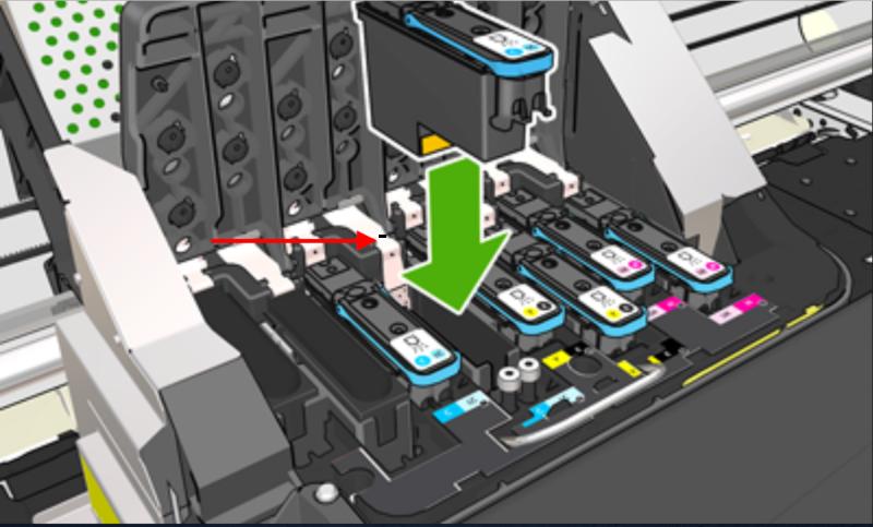

Probably too late seeing as you bought a new set of flats..but maybe beneficial for others
See attached pic. What the crappy stock image will not show is the 2nd set of black dots on the flat cable.
The smaller set should be inline with the 2 black tabs that the arrow points to. (as per all other heads)
They may seem all aligined but try to move the offending slot and see if it is a bit iffy
I have re positioned and glued these back in before to solve problems like this before at a few sites.
