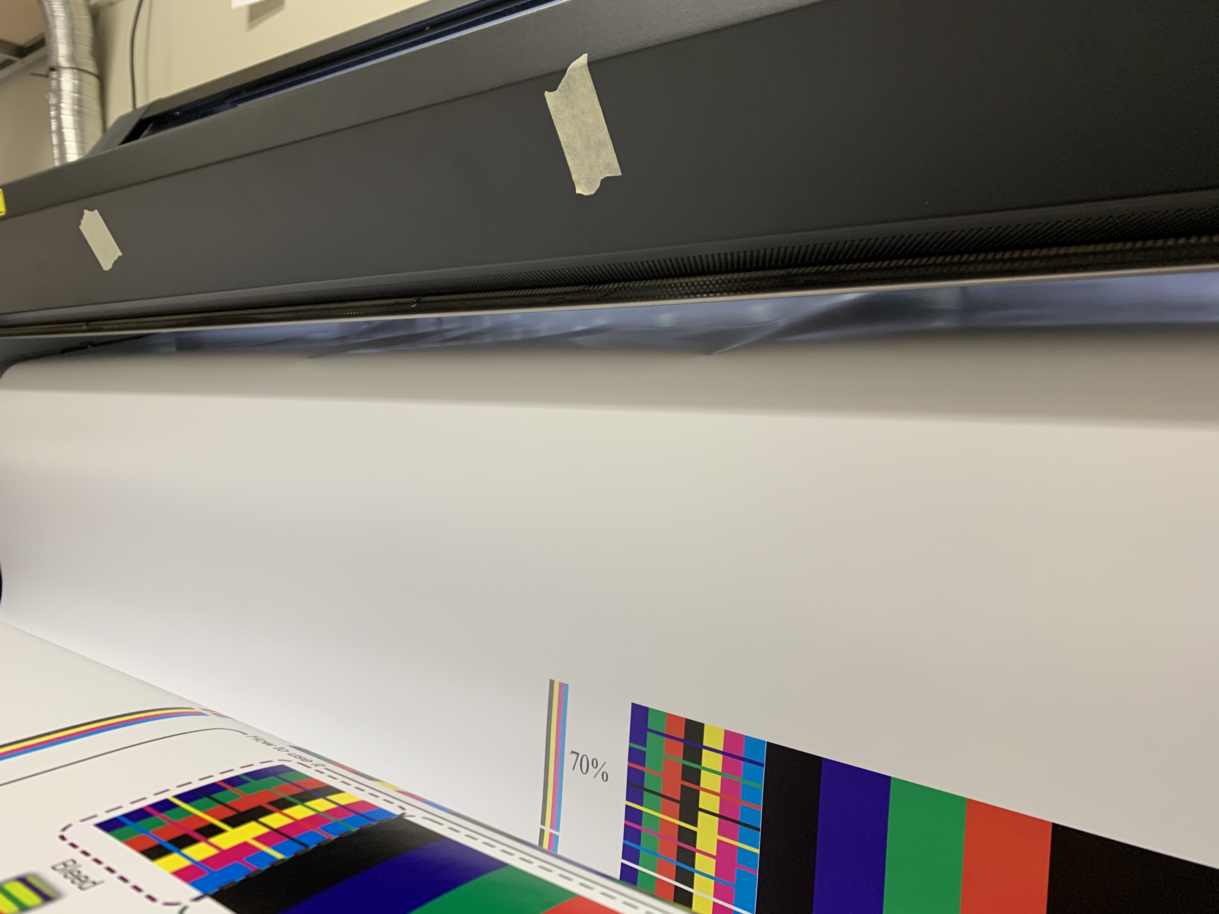

I've been having difficulties printing to this machine for a while. I've been researching all options, have changed media's etc. Looking at settings and does anybody have knowledge about adjusting Heat Airflow Pressure? I do notice that most of my media profiles are at 175 mmH2O.
What does this setting do? How could it affect my prints?

I believe it just makes the fans spin faster or slower to kick the heat down in the curing area from the heaters. Helps with warping media from too much heat or ink not curing from too little. Though that's like the one setting I've never touched, usually I just increase or decrease the temp.

I haven't adjusted this either. I just ran a banner and increased it from 175 to 200, I can't really notice a difference yet. The media still bumps up in the same area which leaves a dull area in the finish.

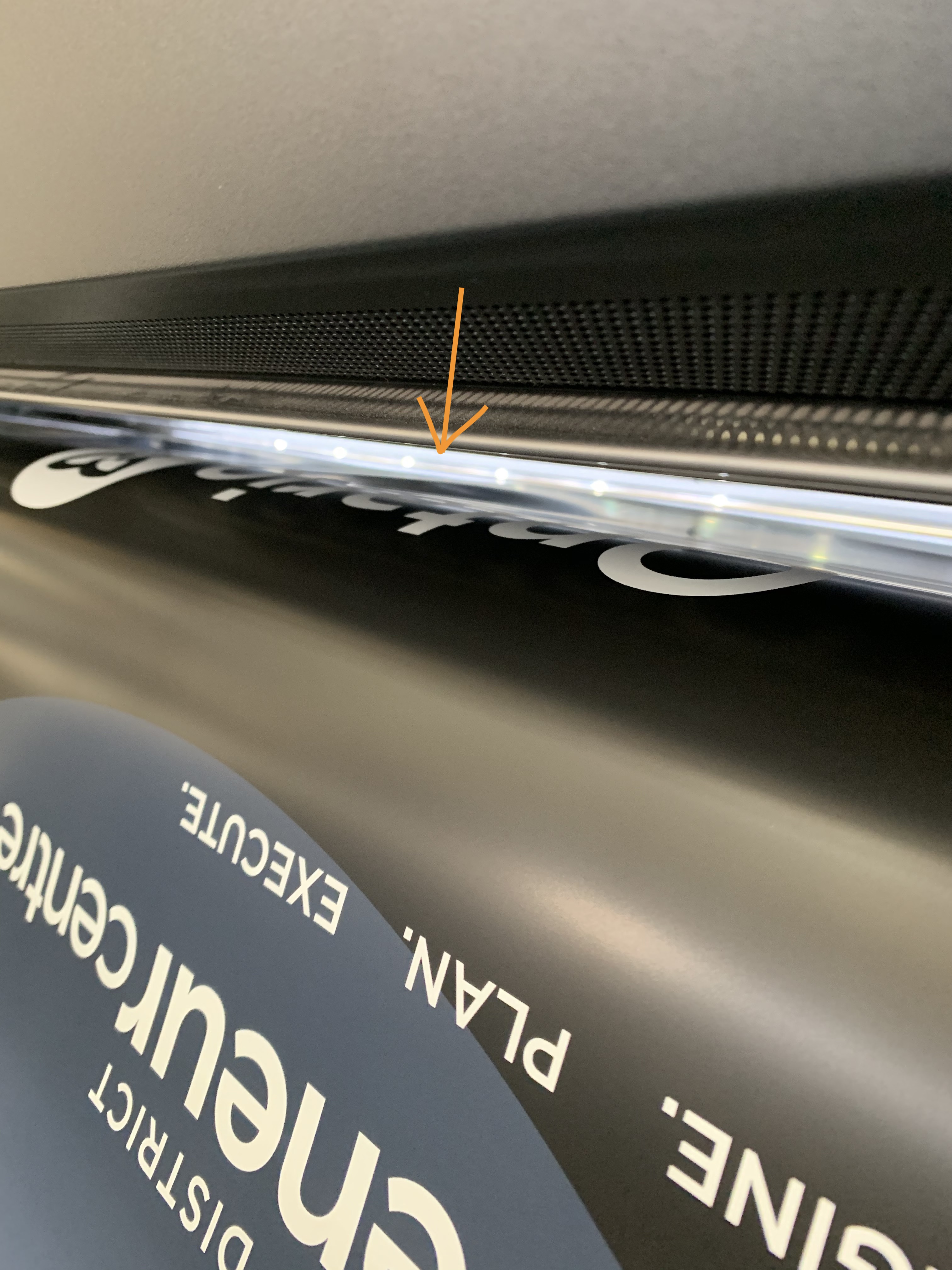

Here is a photo of a different media. A brand new roll of Drytac Polar Premium Matte Vinyl that I was loading and starting to calibrate yesterday. Heat is set at 100°C, ink limit was good at 110% but I've opted to back it to 90% on the printer to save a few bucks on ink. Note the two raised bumps under the dryer. Those bumps are the areas that are the warmest when media comes out of the exit. By laser thermometer they're about 65-70C and when I measure on areas away from those to spots it ranges from 45-55C.

Yup, uneven heat. It's not that bad getting in there, right & left cover, pressure sensor, top cover and then heaters removed in that order. You don't need to remove the entire heating module.

It's beyond frustrating and we've essentially had this issue since day-1 with this printer. And we bought it brand new out of the box but it was sitting in the resellers warehouse for years in original HP crates and packaging. I'm trying to find a how-to video or book on how to do this.
greysquirrel
Its a PM service when this is cleaned. The whole heater assembly has to be removed. Its not worth messing it up. Call in a tech. It should take them 2 hours.
